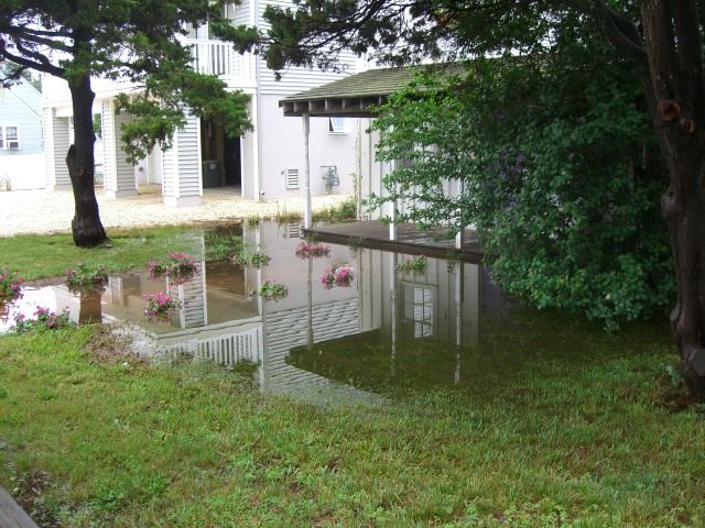

This happened twice this summer. House will be 32" higher after lift. Read here the epoxy comes off pretty easy when you actually screw them in. I guess this varies between manufacturers but the stainless should be a better bet, despite cost. I tend to over build anyway.

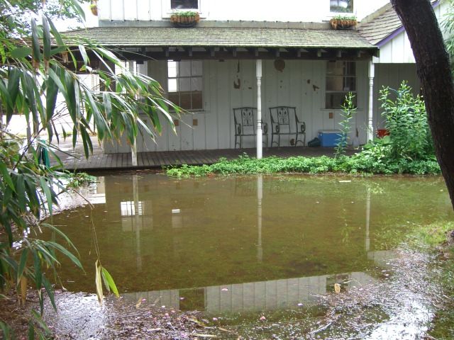

Doc,In the second pic, does that house have habitable space at the grade level? If you lift it 32' how much more would it be to lift it to 9' and park cars or use it for storage?You're propery value will only go up, even after a correction.Chuck Slive, work, build, ...better with wood
yes it's habitable, living room dining room and addition on same level for kitchen bath. putting it that high would make it look ridiculous, given how narrow it is. plus the lot is 70 x 100 which is one of the biggest in the town, biggest on the street for sure. this leaves plenty of room for parking. i drive a f250 crew cab, my brothers got a 150 crew and we have had another car behind those two in driveway, no problem. not to mention parking on street in front of house. we usually take up those spots and keep the driveway open for visiting friends.

bad new is it floods, good news is I now have waterfront property!
