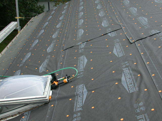

trying out our new toy.. a bostich cap stapler.. great tool !
the roof is stripped and papered in.. Ice & water on the eaves, RoofTopGuardII underlayment, bostich cap staples holding everything in place ( we used to use roofing discs )

here's some of our old roofing discs... and the new bostich cap staples

Mike, info on the cap stapler please? Cost, cost of caps..weight wise worth it etc?
I'll be wrapping the house in felt REAL soon ( finally am there) and looks like my back roof will be needing a tear off...Cu's Latin guys still nail all the caps on ( I don't know why) so we don't have one that I can borrow.
I think I might just buy one..wanna hear your take on it. Please. Spheramid Enterprises Architectural Woodworks
check the prices online... you'll like the gunMike Smith Rhode Island : Design / Build / Repair / Restore
Josh had a Hitachi cap nailer. It left the nail heads too proud of the caps to use under copper and the nails are expensive. I think the nail expense gets washed if we don't get anymore roof planes where we have to back and hand bang the caps after we've shot them. I'll check with Mike later and see if he still likes the Bostich and reconsider. Chileo hasn't been too interested in one.Birth, school, work, death.....................
The Bostich is a staple on. I can see where Chileo wouldn't bother, he is SO damn fast at hand nailing them. I swear he hits em in with one whap and somehow gets his fingers away in time. Spheramid Enterprises Architectural Woodworks
