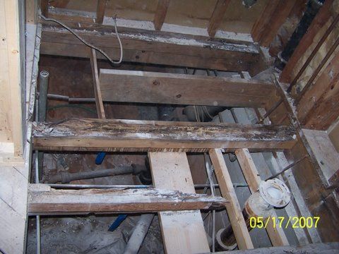

Ripped this out today as part of a larger reno.
The whole ‘McBathrooms” project came out of my noticing all this rot when I put in a sump system a year or so ago. Client got someone to “brace it all up fine” . . .
Luckily, I’m making all this a closet, and removing all the plumbing

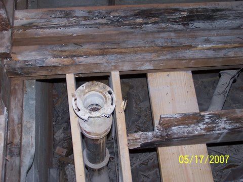

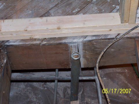

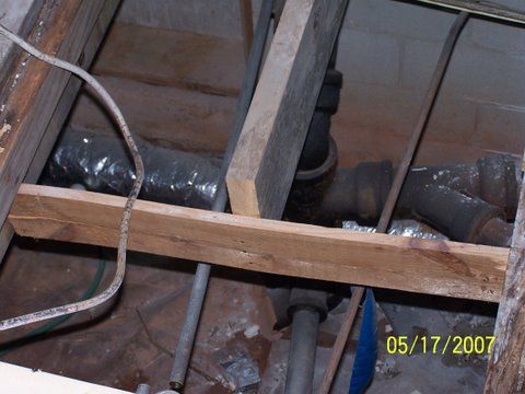

Note that a joist was completely cut out for the toilet drain, and another was cut for the tub drain. House was built in ’59.
You can use a 1×4 header on 2x10s, can’t you?
Blocking has opened up; floor has sunk right at an inch under the tub
All this was still wet, and no-one’s been in there for a couple of weeks

Those are some great photos there. 1x4 header on 2x10 joists. Classic.

Better call Mike Holmes.
