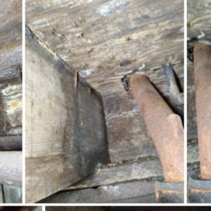

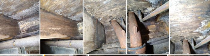

Hi, I have two, maybe three, floor joists where the ends are rotted from water damage.  The pipes are fixed, no more issues.  But, the subfloor also rotted.  I need to fix it all.
When I cut off, say, 3′ from the end, how do attach the new piece?  I know I would sister new boards if I was using only the original joists, but what about the new piece in the middle to replace the rotted part.  How do I attach that to the original, good part of the floor joist?  Most sistering I’ve seen keeps the old piece in the middle.  Should I just do that an sister longer 2x10s along the original beam with floor jacks?  This is below a kitchen, so it will have to hold up cabinets (or help to), dishwasher, maybe a fridge.
These are 2×10, actually they are 9 1/4 because the house is from the 70’s.
