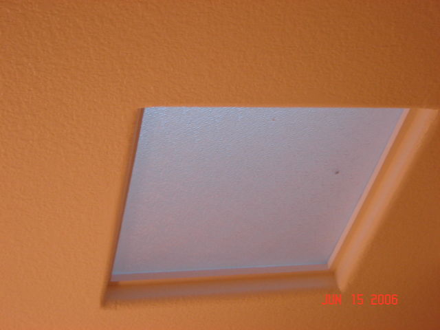

       As others have stated, this would be the simplest fix, might run you $20 &  1 1/2hrs of your time .  This one is in a 3/4 Bath that teenagers use, 5years & problem free.

      Orange ceilings?
      I would have used Photoshop to change the color of that pic first!
