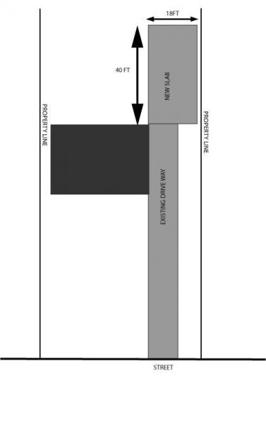

I’m looking for some advice about the best plan of action in regards to pouring a new slab for a garage.
Attached is a rough site plan.
My plan is to pour the slab in one session.
It will be a monlithic slab with #5 rebar around the perimeter and 6×6 mesh on the face.
The question I have is that once I have set the rebar and mesh it seems like the cement truck will not be able to reach the back of the slab with it’s boom.
So am I forced into renting a cement truck with a pump or is there some other plan that would work better.

    1. MPHarper | Jun 06, 2005 08:33pm | #2
      Wheelbarrow.
      Have the truck fill it up and then wheel the mud back where the boom won't reach.

  2. mike4244 | Jun 06, 2005 11:19pm | #4
    Your best plan is to hire a concrete contractor. From your post it seems like you want to pour the slab yourself. You need a minimum of two cement finishers and four laborers to pour this in one piece.Even if your slab is only 4" deep your talking about 9 yards.

    1. JonE | Jun 07, 2005 02:56pm | #5
      Why do you say six people are needed?  I did my basement slab with three guys - one finisher/placer and two wheelbarrows.  22 yards and we had to wheel 15 yards of it because the floor deck was already on.    Once it was all placed, it was bullfloated, and then the finish guy hung around and power troweled it until it was done.  Turned out great.    Only about half of that slab should have to be wheeled, and the front 20' should be able to be placed right off the truck with a couple extension chutes.
      Another way to do that is to remove the front formboards and run the truck right in, pour half, and then one guy can be leveling and floating while someone else replaces and re-levels the front forms.  That way you don't have to wheel any of it.   I see it done with footings all the time.  Remove a section of footing, and then as soon as the truck backs out, replace the forms and pour.  Takes a few minutes, but shouldn't be a big deal.

  3. davidmeiland | Jun 07, 2005 05:09pm | #6
    First of all, it's CONCRETE and not just cement. Start calling around and asking for a delivery of cement and you're definitely going te be distinguishing yourself.
    Sometimes a pump is the best way, even if it costs more. I hate wheeling mud around--I would rather get all of it off the truck right away, screed it down, and start waiting.... save my back for the finishing. Around here the only pump is a boom, and I've learned to appreciate that, because one guy can place all the mud and there's no hauling a hose around. Anyway, I suggest you spend the $300 or whatever and get a pump. Ask your CONCRETE supplier who they recommend for a small slab pour and they should refer you to a guy with a small line pump.
    I'm somewhere between Jon and Mike in terms of manpower... I would do that pour with either 3 or 4 guys, and at least 2 of them able to handle finishing tools. With a line pump you need 3... two on the hose, one with a rake and shovel. The pump operator will not help much, since he's running the pump.
    If you've handled a lot of pours you can probably do what BrownBagg says and remove some of the forms for the truck to drive in. On a DIY job that might be a disaster.
    1. jarcolio | Jun 07, 2005 08:41pm | #7
      we move concret 28 feet -- if the truck can back into the driveway -- build yourself a plywood chute -- the truck's chute is 12 feet, your 12 foot chute will get it to the back and move your chute as you have to -- if you do nothing else, get a vibrator -- well worth the rental fee
  4. MalibuJim | Jun 08, 2005 02:11am | #9
    There are a couple other good reasons for getting it pumped.  First, you're saving wear and tear on your existing driveway- a 10 yard truck is not forgiving.  Also, I know that it takes about 30 minutes to pump out a 10 yard truck, so it will take allot longer with wheel barrows and then you'll pay extra for the time.
    You better have enough people (at least one or two experienced) ready to work fast if the load starts to go off fast.  I've seen this happen on hot days and it's especially bad when you get a "hot" mix right out of the truck.

  5. Notchman | Jun 08, 2005 04:56am | #11
    Get a line pump.  You'll get a good consolidation (little or no vibration needed), you won't spill any, the truck is clear of your forms and the hose guy on the pump will do the placement....your responsibility is to screed, make sure your forms don't blow, float and finish.
    I used to do all that wheelbarrow stuff, and back trucks onto wire mesh and create a mess, and vibrate and tap forms and still ind up with voids and have helpers spill loads.....
