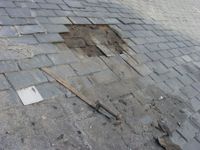

John,
This job was far from my best work-it started when Stephen and I talked about Crappy repairs to slate roofs. It was an apartment building that really should be re-roofed with Archys-this was only a temporary fix.
The nails were just steel nails,not even galvanized-so numerous slates are just loose and falling out. I've invoiced out this repair and when I talk with the owner I'll suggest a re-roof in the Fall. There are a lot of good slates on that roof which I can use elsewhere for future repairs on other homes.
You can see from some shots how the nail is gone with the head fused onto the slates. These were really nice Monson slates-some of the best roof slate ever quarried.

Duane,
These aren't punky at all-they're harder than the hinges of Hel#. Wonderful slates that were nailed with iron nails which combined with the slates iron content to almost fuse together.
If the nails hadn't failed the cretins with the tar pots wouldn't have slathered it all over the place and I wouldn't have had to repair this roof.
Hated to be seen on this roof since the repairs are only a stop gap measure,but am looking forward to the annual Fall slate harvest.
Walter ( As Forrest would say) licking my chops
