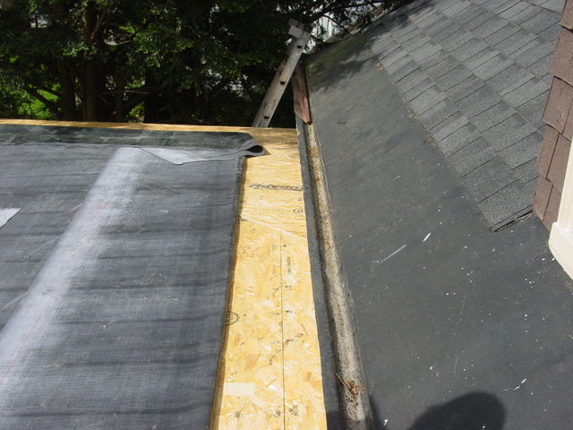

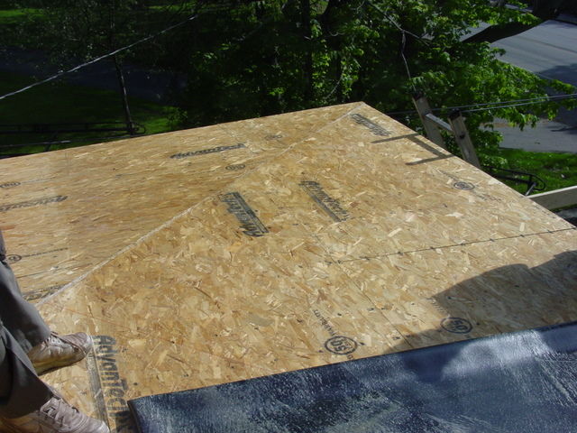

Helped some buddies today with a fully adhered .060 EPDM roof on a nice new porch that they’re building in our College town up river a ways .
Freshly framed and sheathed with Advantec . Butting up to the house and real tight in the middle under fascia and soffit area .
Had to hold back against the house to have room for me to roll the overlapped sheet back , glue it , then roll it out for the fully adhered end result .

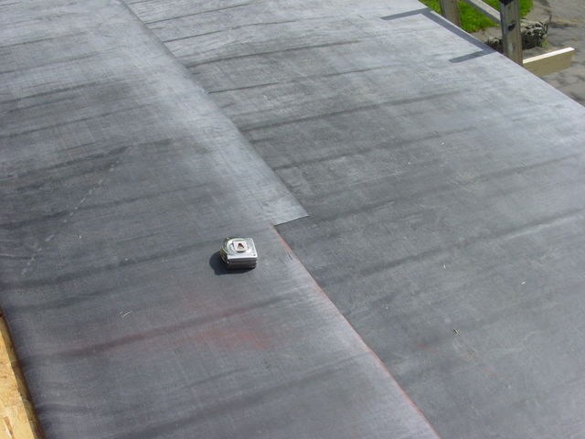

If you're wondering where your tape measure is, look for the lump in the roof.
Some more of our rubber day .

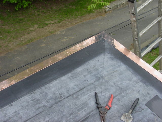

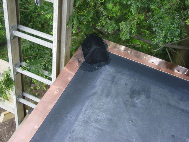

Field rubber is down , we've fabricated and installed the copper drip edge .

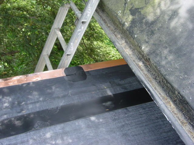

I hem the roof side of the copper so it doesn;t cut thru the neoprene .
Then I cut and glue on a patch over the corners and lap joints so the neoprene is less prone to wear .
I like that detail. Quicker than soldering, which is what we normally do.http://www.quittintime.com/ View Image

Funny the coinky-dinky, I just did two jobs for Grant using rubber and TPO last week. I too was under a soffit, barely able to fit my shoulders in, and the fumes and heat was murder..I have a few fone pics only, I won't use my gooder camera on a rubber day, that glue and sticky tape, gets on everything.
On the second I was using your old ripper to save the shingles I was going under ( closed valley, and way screwed up job by some hacks) I was thinking of you. I said " Well , what would Walter do here?" LOL
I still miss my Stortz, but the Pexto worked better than any other tool, to open the shingles and let my save them.
I din't have any corners to deal with, but like Grant, I like that patch Ideer. Also the extra hem..gonna note that.Spheramid Enterprises Architectural Woodworks

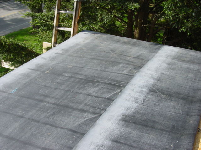

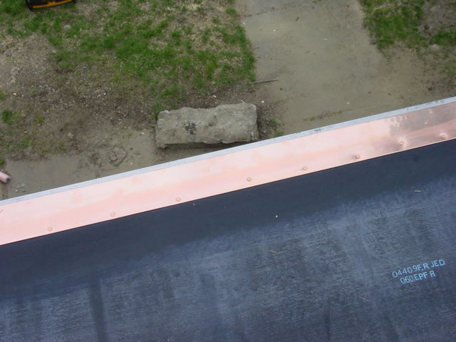

Final sequence for this little job .
" Felt stripping " with neoprene , you can see where we've washed the field rubber .
Glue down the neoprene and seal all edges with lap sealant and we're done for the day .

Making rubber work look attractive is like teaching pigs to fly !!!
We put it down flat as a board though which is my standard for a good job .
Puckers are a sign that something went amiss .

seen a guy put on a rubber roof one time full of bubbles it looked horrible he said ah when the sun hits it you'll never know. sure nuff the sun laid that stuff flat as could be suprised the heck out of me.looks good! by the way I do it like forrest never could figure why the extra step my way has worked well for me, but hey, to each his own. carry on.
Mike ,
There are two types of bubbles that you can get when putting down a fully adhered roof .
The first is caused by simply not waiting for the " elephant snot " to dry completely and you get spots where the glue is still " off gassing " and making the sheet not adhere properly until the glue does dry fully .
The second type are puckers put in by mishandling the rolling out process .
These are permanent , caused by poor application .
With membrane you're not supposed to lay the field rubber over your flashing edge metal , but you can do so if you wish .
Walter
Actually, there's a residential spec from some manufacturers that allows that since it looks better. Seam tape is used at the edges. I only do it when appearance is tantamount to function.http://www.quittintime.com/ View Image
I hope someone has a magic way of cutting that tape neatly. I finally settled on my ancient Duck bill snips, they worked best.Spheramid Enterprises Architectural Woodworks

Grant-- I do it that way all the time------except I usually use latex adhesive in the field and contact cement around the perimiter( say 6" or so) like it or not-- looks are always a factor-----

Cool, but why in the world does the copper go OVER the membrane? I always have the Seal-O-Flex go to, and even sometimes wrap it down the drip edge for a better run off. Sometimes I'll rabbet out the AdvanTec 1/8" or so, for the drip edge not to kick the edges of the membrane up, and make a tiny dam all around.
Seems a shame to have a nice membrane, then a little gooped edge dam all around.
Just askin'
Forrest ,
The edge metal is holding down the field rubber from wind uplift .
Thats the way I was shown to do it -- an accepted practice with fully adhered EPDM .
I've done them off and on for the last 20 years and never had a call back , so I think it performs in real life situations .
A membrane roof isn't a work of art like a locked seam or standing seam copper roof -- just functional .
Best , Walter
Stripping in like that is a standard detail from way back in BUR days too. It is an extra layer of protection. if you simply run the copper flashing first, then the membrane over it, if there is a break in the seal, water will wick back in under and then you have rotted decking.but with the membrane under first, if the seal on the neoprene cuts loose, the underlying membrane still keeps water out of the structure.Walter really goes the exta mile. I have never seen the hem there before. it could be a major benefit in a location where there is a lot of snow/ice or high traffic zone causing movement of the parts.

The folded back roll takes a bit more practice rolling back into the glue so you don't get puckers .
