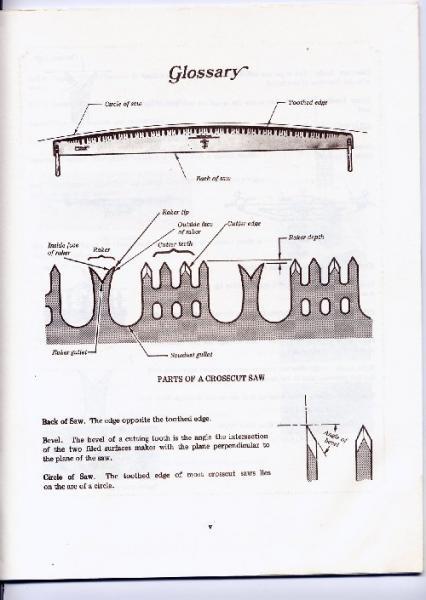

        1. FrankB89 | Jul 21, 2003 05:49am | #19
          If all else fails, you can always go this route:
          1. Piffin | Jul 21, 2003 04:51pm | #30
            That's not a saw. That's a page out of a book.
            I can run out to the shop and get a picture of the real thing, if you want.
            No worries about fuel mixture with it!.
          2. FrankB89 | Jul 22, 2003 07:22am | #44
            Sorry, no time to take a pic.  I've got 11 of them, from 5' to 9 1/2'.  All sharp and useable, were mostly my late Dad's; from CCC camps to logging in the early 50's.
