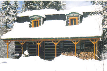

            Dinosaur | Mar 16, 2009 04:28am | #39
            Here's an illustration of one type of modular guard I'm familiar with. With your 3' snowpack and your concern about the look from ground level, something like this would probably be a good choice.
            Here's a link to the manufacturer's website: http://www.renodirect.ca/Pages/GardeNeige_new.asp
            You probably only need the one- or two-hole plates. We don't install three-bar guards except on roofs with particularly long slopes or steep pitches.
            Failing that, get in touch with a local wrought-iron fabricator and have him weld up an 8"-high, two-row barrier for you out of ¼x¼ stock. My local guy makes them in 8-foot sections with feet spaced either 16" or 24" O.C. (depending on the roof framing) and one 20"-long angled strut (going up the roof) for every second set of feet.
