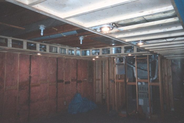

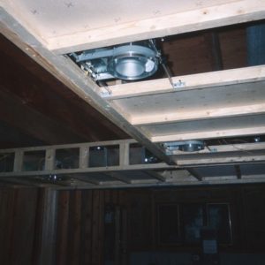

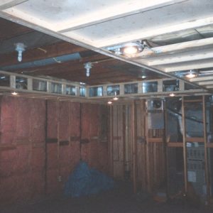

Just framed some soffits around basement ductwork last week. The frames are just 2×2’s but are sheathed on the topside with 1/4″ baltic birch plywood.
The frames are quite light but were also strong and straight.

    Nice.  Would 5.2mm luan have done the job, rather than the BB?  My guess is that the luan would have been quite a savings.
    Why the skin at all?
      basswood | Dec 01, 2005 03:40pm | #3
      The 5mm 5-ply birch was $12/sheet and much stiffer than the 3-ply luan which is about the same price here (but a 4x8 vs the smaller 4x5 birch).Some of these soffits are 42" spans and the 2x2 stock is so goofy that I wanted to add strength and keep things straight. It worked well enough that I'll use this method again.
  2. Piffin | Dec 01, 2005 06:59am | #2
    I'm scratching my bean trying to figure out why? If you needed the stability to keep things straight, there are cheaper plywoods.
      basswood | Dec 01, 2005 03:47pm | #4
      I probably spent an extra $40 on the underlayment grade birch (10 sheets) vs. luan. I just thought the extra stiffness was good...maybe overkill though.

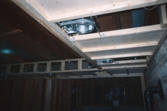

  3. Hackinatit | Dec 01, 2005 04:12pm | #5
    Why did you put the ply on the soffit joists rather than the studs? That would provide some strength to the floor above.

      now I've seen pics of your handiwork basswood, but hack in a #### now has you beat .. and is in serious need of a life!!
      1. Hackinatit | Dec 01, 2005 05:05pm | #8
        Life? Customer's attic is over those trusses. He also hates "bouncy" anything. Big loads need Big support.
        He wanted soffits in the master bedroom. He asked if I could find a way to add support to the floor above without adding loads over the old 2x8 window headers on each side of the room.
        I proposed this and he accepted. Then he paid "time". Everyone's happy! Good for Life.
        BTW All the webbing is salvage from the teardown.
         Troy Sprout
        Square, Level & Plumb Renovations
      basswood | Dec 02, 2005 04:02pm | #9
      I did not need to stiffen the floor. I just wanted to get straighter stronger soffits (SSS). The skin on top will both keep the 2x2's in line and keep the weight of drywall from causing a saggy soffit, even at 42".Your soffits look both sturdy and well done.
