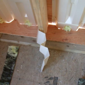

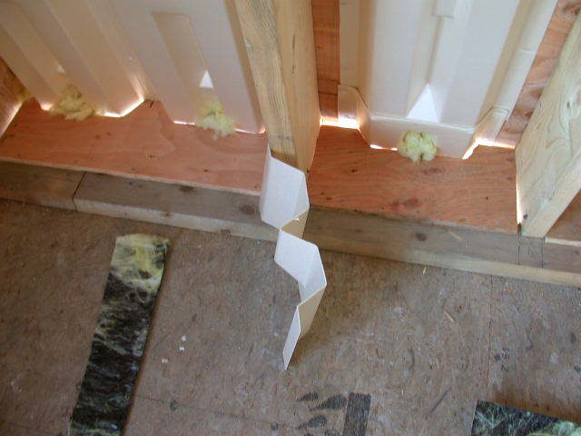

    anthony... after you staple it in like sphere said.. you have to add blocking around the baffle to prevent the cells from filling the soffit..
     we do this a lot of different ways.. you can use thick cut-offs of fiberglass insulationas a dam..
     you can custom cut plywood dams that fill snug-fit around the baffles.. these get nailed up on the exterior during framing.. usually before teh roof sheathing goes on  ( if you think of it in time)...
     you can make a dam out of foam stock that will fit around the baffle..
    here's some plywood dams cut to fit around the baffles on a lower roof of a gambrel...
      abutcher | Jan 21, 2004 07:13am | #3
      Thanks for the picture. These are going in a 30 yr old house with a 6-12 pitch roof. I think I will try packing in the insulation batts instead of cutting wood. You Do good work.
