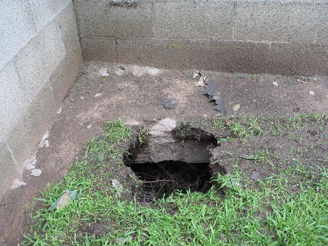

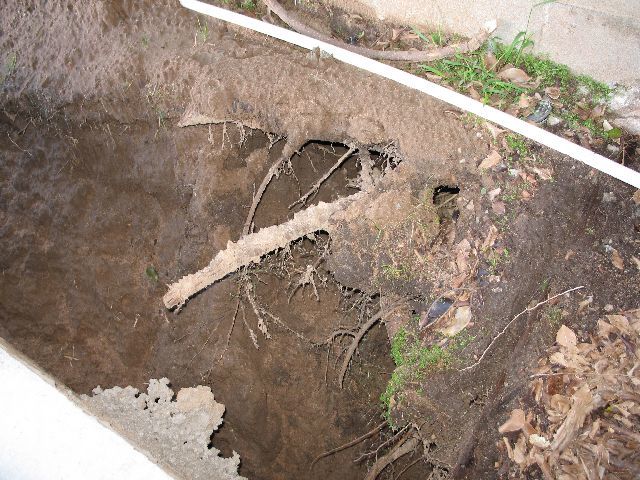

I have a 6 ft tall masonry wall on my property boundary. Blocks have horizontal and vertical rebar and it’s tied to horizontal rebar in the concrete footing. All blocks are filled with grout.  It’s well built.
New construction started on the property next to mine. They lowered the existing grade 5-6 feet on their side, to within 2 feet of my wall’s footing, and built a poured concrete retaining wall on their side.
They did not compact their backfill behind their new retaining wall.  In addition they did not pull a permit for the work and it appears the retaining wall’s design (height, no drainage, etc) is non-compliant with applicable codes in my town.   Chances are the inspector will stop their project.
But here’s my problem:  recent heavy rains washed away some of their retaining wall’s backfill.   Their retaining wall was not contiguous, so muddy backfill found it’s way out and washed away.
This exposed my wall’s footing in several places, and the original undisturbed soil  under  my footings has washed away in several places.  The footing has sections where as much as 2-3 linear feet of my footing is spanning empty air, and I even have sinkholes open up on my side of my masonry wall, where my soil slid under and away from my footing.
The original grade on their side (before they lowered it 5-6 ft) was level, flat, and had been undisturbed for at least 50 years. Rains in past years never caused any erosion or any problems.
Attached are some examples.

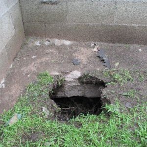

  • Footing pic is taken from their side. My wall & footing is in upper-right corner. The bright white in lower left corner is top of their retaining wall, spaced about 3 ft from my wall.
  • Sinkhole pic is from my side of my wall,  directly on the other side of my wall
What are my options for restoring proper support under my walls’ footing?    Seems I need some kind of structural underpinning now.

      1. Prevent further erosion. It looks from the photos like the first thing to do would be to block that gap at the end of the neighbor's wall and replace any missing fill to bring it up to original grade on your side. Then you can tarp it to drain any further rainwater to a safe (non-erosive) place.
      2. Get temporary support under those footings. A two-foot gap undermining a well-built wall like yours probably won't cause damage immediately, but you ought to think about forming around the gap and pouring in some concrete to replace the washed out fill. A plywood or 2x form supported by fill on the outside would probably hold well enough for this. It doesn't matter if the form swells some; this 'patch' will be buried afterwards thus unseen.
      3. Have a PE design a permanent solution. And, of course, the design fees get charged off to the neighbor in the lawsuit, too....
