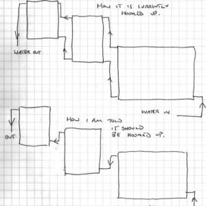

I have a client who complains her pool solar system is not effective. The original install insists it is hooked up correctly. My solar guy says that since the panels are set at different elevations the hook up should be different. See attached drawing
Since I know little of this technology I am not sure who to belive. Any thoughts would be greatly appreciated.

    Assuming that the water circulation is with the filtration system, I would be concerned that the modified set up running the panels in series may produce too much resistance and thus drop the flow rates too low for proper filtration.  I work with a condo complex pool which is considered "public" and thus has health department inspections which require a certain minimum flow rate (the entire volume of the pool needs to go through the filter in 8 hours).  When the solar heater is on, the resistance is increased and the flow rate decrease significantly in a lay out similar to your present set up (all panels in paralell).
    I would check the temperatures when it is operating in good sunshine.  Even though they are black in strong sunshine, they should feel only slightly warmer than pool temperature.  If some panels are cool and others are hot, then there is a problem with the water mostly using only one panel.  It appears that the path is nearly identical lenght and resistance through each panel, I would be suprised if that is the problem.
