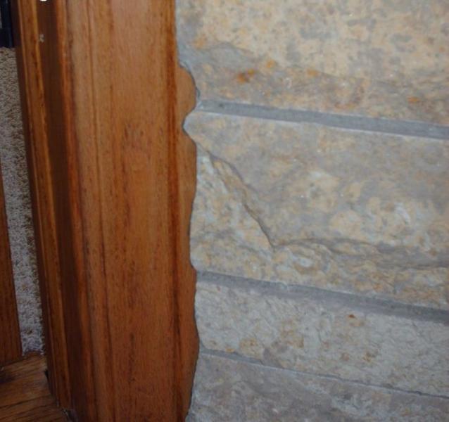

This piece of casing adjacent to a stone fireplace took an hour to fit (had to be both scribed to the stone shape and back cut due to the angle of the corner fireplace).
Just got home from a few hours of “Sat. catch-up work”. I hope the HO’s like it.
Looks like you poured that casing. Nice job!
Thanks Lee,I thought I would trim a few more doors today...but that one was a doozy. I finished that one and said, that's enough for today. <g>

Thanks Jon,I wonder if the HO will know what it takes to do that. That is one reason I post some stuff here...some of you know how fitting trim to stone can be a bummer, but it is a great feeling to pull it off.
It don't get no better than that.................
Did you use an angle grinder?

Nikkiwood,Thanks.--"Did you use an angle grinder?"Yes I did, back to back 36 grit, and lots of ventilation, I scribed, grinded, fitted and repeated four times.
Next thing we know, we'll hear ya been doin' delicate surgery with that grinder.How about your scriber? I like that Fast Cap 2 legged thing, but I am guessing for this you had to use some sort of regular compass.********************************************************

I taped a Sharpie on a compass.I used to think grinders were for rough work...I have had to change that position after learning to cope with a grinder.
"Sharpie"???? Great idea............ I never would have thought of that.********************************************************

I didn't know they made caulk with oak color and grain <G>
seriously, nice work.
It's gratifying when work turns out that well.
Thanks Shep,I'm glad I got that done...I have seven more openings to trim in that house Monday--the rest should be easy.

When different elements in a home run into each other, it often demands our best work......but truthfully, it is often the result of poor planning. The outcome is fine, in this case, but if the door was placed just one inch further to the left none of that craftsmanship would have been needed.Perhaps there are better ways for me to spend an hour than fitting a single stick of trim. I am conflicted. ;o)
I hear you, the window sill was a result of poor planning between the gc and the kitchen place (or maybe no planning).never the less, the bill should help the kitchen place remeber to consider the details better next time."it aint the work I mind,
