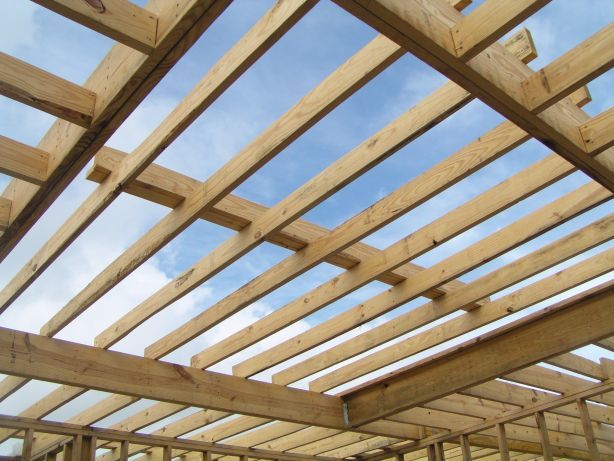

anyways I’m going to post a few pics of the progress and try to keep up with it. This one has been fun so far, doing double step ceilings for the first time and 26′ 51/2″ plumb to plumb rafters and long
hips and such.Got it covered.

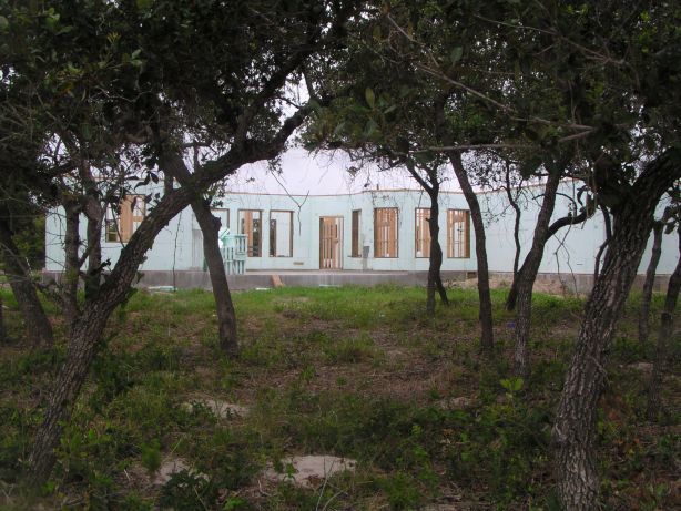

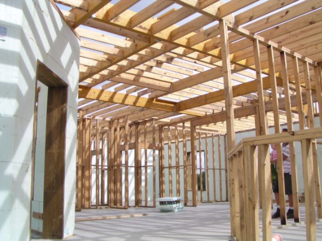

take a look and tell me what ya thinkk of my building.
RTC
It's very white.

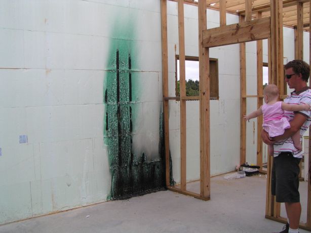

Are you doing that for a builder or for the owner? What's a yard of concrete cost down there and why did you get a blowout?
Yeah we get pretty good surf here, just not very consistent. Went spearfishing last week at our new jetties. Lot of big snook and large snapper.pretty cool.
The blowout was pretty much unexplained it was NUDURA block and it just broke the plastic.Wet batch of concrete could be to blame.

What's the story behind the arson?
Problably some kids in the neighborhood. They left behind a bottle of lighter fluid problably after the fire got bright and they took off running.................RTC

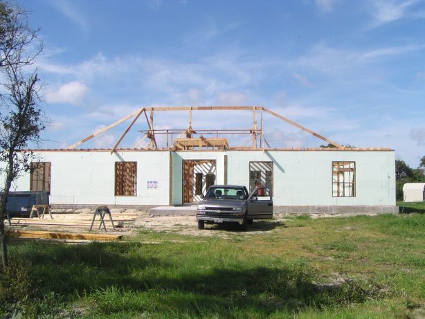

Do you always keep your site this clean, or was it just for the pictures...?
Was the blowout in a window buck, or on a corner - how do you brace these?
What is the market like for ICF homes in your area? - I've given some thought to marketing them locally.
I try to have the site clean everyday ,it makes work much more effecient.
The blowout was by a corner. no bracing is required but some people run 2' strips of ply up the corners.

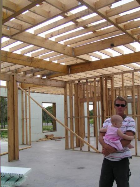

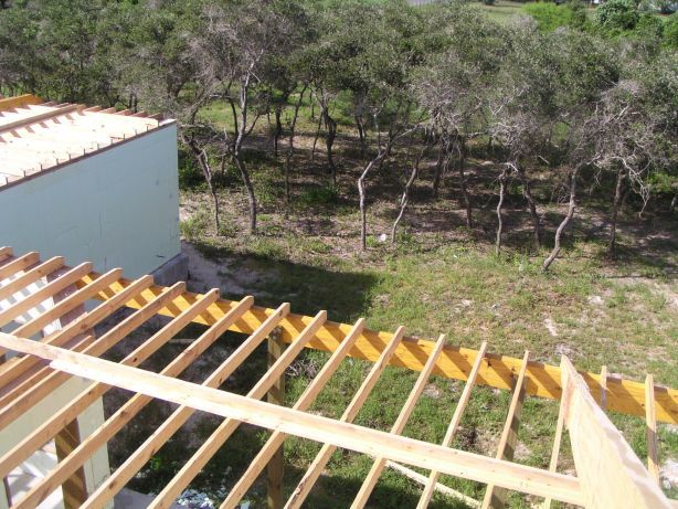

nice work, but it looks like you need some support under your strong backs, especially in the single step picture, the strong back ends over the last joist but is not supported by the beam. I always run what I call wall ties from the wall or beam to the last joist and make sure my strong backs sit directly on top of these, it really helps support the weight. What part of south texas are you in ? I'm up in north houston, waiting for some good waves also...
your'e right . I had my rookie but those on. Theryr'e right on a fe and wrong on a few.We'll fix em..................RTC

Looks nice! Clean work, what type (brand) of ICFs?
Bet Boss Hog could make life a-lot more enjoyable, with a truss package for that Casa!
Trusses would have been nice but with all the stepped ceilings, I decided to stick frame it..............RTC
NUDURA ICF they come in 8' lenghts as opposed to the normal 4'. 18" tall compared to 16" and they fold flat for shipping. 6" core.
