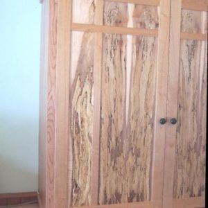

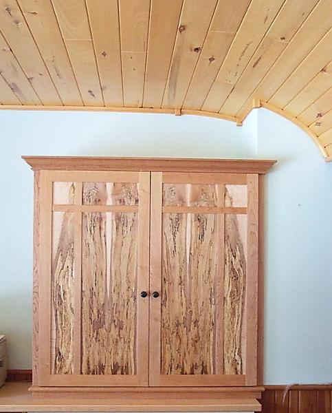

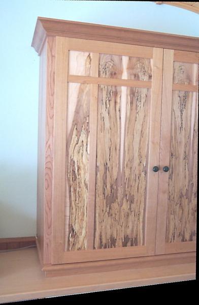

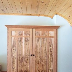

OK it’s only the upper part of the wall unit. The wife requested some extra storage space and since my sweethart of 20 years never asks for much I decided to get started. The unit now sits on a long counter which acts as the computer desk, eventuelly I’ll replace the wood top and all the pine drawer units with matching cherry cabinets.
panels are bookmatched spalted veneer. The mulls in the doors were a way to make the best use of the boards I had. Both door panels as well as the medicine cabinet panels posted earlier were cut from one board.
Photo of upper unit and a close up of one of the doors.

      Thats some wild looking grain. Was it hard to cut?
    Thanks for the pictures, nice to see something different for a change.
    1. riverman | Jan 19, 2006 07:19am | #4
      The spalted wasn't difficult to cut. The biggest surprise was the panels warped like crazy. The panels comprise of spalted face veneer, 1/8 baltic birch core and a maple veneer back for a total thickness of 5/16. Apparently the spalted soaked up more glue than the back veneer and as it cured shrunk at a greater rate causing the panel to bend. I ended up sanding the back veneer off and replacing it with a lesser grade of spalted. Aspen may have worked as well but after all that effort I did't want to do it a third time. Some words were uttered that are not in Websters book. I guess one is never to old to learn something new.
