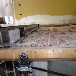

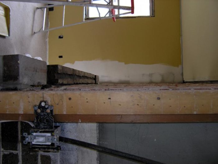

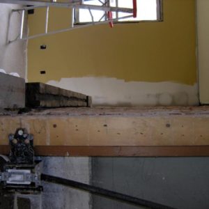

I have a brick fireplace wall that I need to drywall. I’ve seen old discussions on this, but I have a few unusual constraints:
1. The brick is not level.
2. The brick is proud of the surrounding studs.
3. There is only about 3/4″ of space available for the drywall in order for the existing mantle to fit back as it was.
How can I attach the drywall, keep it level, and not consume too much space so the mantle can fit?
There are three pictures attached that illustrate the situation.
Thanks,
David in Iowa
  1. DonCanDo | Mar 23, 2005 12:45am | #1
    How about expanding foam?  You could temporarily attach some lumber shimmed out just the right amount and then fill in the remaining gap with expanding foam.  After the foam dries, remove the lumber and attach the drywall to the brick through the foam.
    I would use waxed paper to make is easier to remove the lumber (say 2X6) and I would space the lumber no more than 16" OC.  Probably less, but it depends on how much foam you can get in there.
    -Don
