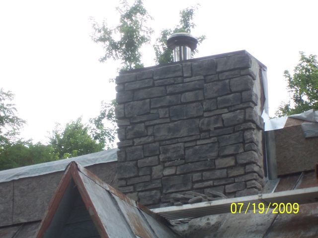

Got most of the rock up today, need to do the sides and back when I get more wire up.
I wanted sand stone, but this granite was in stock..corners too.
Thanks to all who offered advice on the mix, it came out as good as I could do for a first timer with no idea what I was doing..LOL

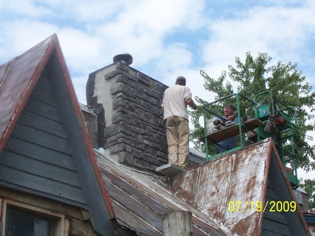

A biker buddy from Canada came by to visit, I put him to work, but was already way up.
It looks great in real life and makes the house happy.
I need to figure out what to do on those inside corners..maybe a 4×4 of Ipe.
I’m gonna have Hardie Lap and metal roof on the ridge line..thats next while I have the Boom lift…THANK YOU GRANT!!!!
I’ll grout and finish tomorrow I hope.
We love it, 6 yrs waiting to do this, its the icing on the cake.
critique is welcome, I love pointers. Get it? Pointers?..LOL

I have done some of the rounded stones on a interior once. Only thing I did was try to keep the largest stones towards the bottom.

Ok, I just boomed up the first 8 12' lengths of hardie plank..jeezus, what was I thinking? That stuff is gonna be a royal pain to hang solo...might have to revisit your vision.
Gonna sit here and drink a cold tea while make my plan of just how to stay up there and actually nail the stuff off..I can't get the basket close enough be/c of the step under it, it hits the roof too far back away from the ridge to be useful.
Looks like a fun evening headed my way.
Stay tuned for film at 11..Spheramid Enterprises Architectural Woodworks

On the inside corner issue, I'd either install a corner board with flashing behind it primarily to get out of coping the siding to the stone. Butt both the siding and the stone.
http://www.quittintime.com/ View Image
It is flashed wide, like 4" from the actual crease both ways and laps over the side of the chase bottom/roof flashing.
Corner board it will be. I shudder at copeing the siding to the stonework..both now and future caulking, I ruled that out.
I'm thinking to mimic a REAL chimney, I'm gonna tuck in lead reglets on the sides when I grout and try to mask the fakery...dunno for sure, just wondering if I could pull it off visually.

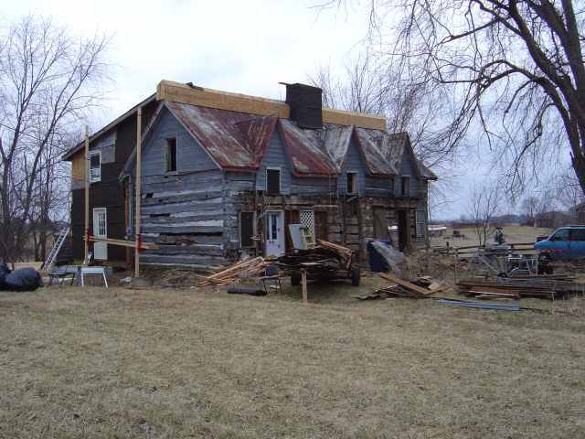

Really nice job there! Is that daub & wattle, log & chink on the original? I can't see worth a damn anymore. How old is that place?
About 1830-40 ish is the best guesses.
The old stuff that was between the logs was mud and rocks mostly, then lime and mud plasterd over that.
I got it all out, used 2" ridgid foam and squirt foam, next after all the high stuff is done, is add the wire and a similar mortar mix.

No, the addition was here when I bought it. It was incomplete because he died while doing it.
That goofy roof line is because he set the shed roof rafters ON the main house ridge, like above and OPEN to the elements. He wasn't a carpenter..there was a gable dormer out back, and he framed the shed roof with the tip top of the gable poking up and out of the shed roof..no, that wouldn't leak..duh.
We live in the addition, the log half is my shop downstairs and storage/music room up stairs. The addition needed as much help as the log house did..I just didn't know how bad it was at first..but hey, it was a STEAL.Spheramid Enterprises Architectural Woodworks

Hey, man looks good!
Seriously, nice consistant joints with the double stack
thrown in when apropiate.
keep the mud dry for the joints. Fill it and wait till it wont smear before ya touch it again.
If you do smear it up- wire brushing the next day (no excuses).
Thanks, I'm gonna skip the bag and point off a hawk I think.
What ya use for a sealer on this stuff?
I never did anything like this before, so I'm glad to hear I didn't PO any real masons..I have about 3 stones I'd change if I could, and forgot a few wedgies I didn't remove yet..for the most part, they stuck good, I did have ONE jump off and go all the way to the ground..LOL
It is harder than it looks on TV.Spheramid Enterprises Architectural Woodworks
Oh, just check your masonry yard.
if they are clueless the tile shop. Any quality masonry sealer is good. Just nothing with any
gloss.
10-4. I hadn't considered that step till you brought it up.

I do have a question...did you use chicken wire or expanded diamond mesh? If you used chicken, I'm guessing it's holding the scratch coat okay?And seriously, it's a nice look. Good job.Oh, and careful with that red hanky hanging out of your back pocket. Might get you into trouble. Just ask Al Pacino.Oh, and don't tell anyone, but I'm not a Per Mod. I'm the Peer Mod's mod.
I used real mesh. I bent it in my break to get nice crisp corners. Little did I know the lickem stickem stone didn't care, they were all over from being true on the inside corners.
I think I got a good deal on the stone, they threw in an extra box of corners, cuz they had it in the warehouse. I don't have a LOT left over of flats, but plenty of corners..LOL. I can use some in the kitchen ( logs have been stripped, need filling inbetween) and cut the corners and use them as chinking exposed.
Just glad the chase and rafters held the load, it worked out heavier than I planned. Lucky, the house is stout, and I beefed up the rafters way back when.

Yo buddy, I'm getting some cracking in my pointing, my mason bud said it would, and try to keep it wetter longer.
If I do that ,I'm afraid the color will run and stain..should I maybe just mist it? I tried a big acid brush, and it didn't set well with me.
My mix was 6 sand, 2 S, 1 (heavy) lime..I guess the lime makes it shrink more?
5 applesauce scoops ( like Dino's D-Mix and Dunkin Donuts , LOL) of ochre dye..I like it so far.
Here is the west face.
I'm not near done yet pointing, I ran outta energy after 10 gallons of mud...THANK YOU for the tips, "Dry, leave it alone, brush.." That seemed to be the ticket..I bought a 3/8th" pointer, glad I did, all I have here is a goofy brick spoon and a Ford Brake adjuster tool..LOL
Edited 7/21/2009 5:41 pm ET by Sphere
Hard to tell from here. I doubt it's the dye or the mix. If the mud is to wet it will crack. To old (kicked earlier in the day). Most common problem is drying out to fast. Is the sun beating on it?
Did you wet the rock first? Perhaps a quick review- Stiff mud, compressed into the hole.
Wait till it is past the smearing stage (very important as this also avoids shrinkage after you finish). Go back over the whole thing again and strike the joints.This
can be done many different ways but I - compress and scrape everything back to a uniform depth.
That stage does away with any shrinkage that may have occurred. Then I use a "throw away" china bristle brush to achieve a
perfectly sealed and uniform joint.
Other then that no idea. OH !!
I have had dirty sand kind of separate (crack) once too.
Hmmm. I Didn't wet the joints first. I also didn't make a second strike pass, I just used round stiff parts washing type brush to both remove excess and smoothe out.
I gots the other half to do yet, I shoulda started on the back "no see" side. Mebbe I can brush/ smear a little more into the cracks, or just live with it. I'm running out of time with the boom I'm afraid, and soon gonna have to get back to some paying work.
Man, that pointing took more mud than I woulda thought too..I didn't retemeper any old stuff, it was getting away from me at the end of the second lift and I quit for the day, rain coming tonite and Wed it looks like.
