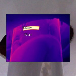

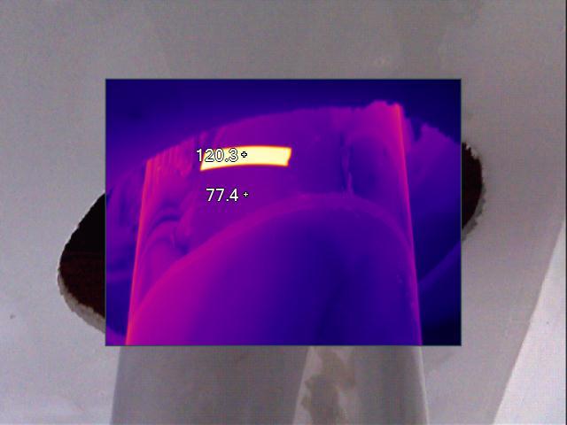

            Here's an image
            of a piece of Metalbestos Ultra-Temp stainless steel flue pipe where it penetrates a cathedral ceiling/roof. The hot rectangle is a piece of Scotch #33 electrician's tape stuck to the pipe. E = about .95 on that, which is what the imager was set to. The stainless itself appears to be about 40 degrees cooler, but it's not.
            MarkH | Feb 08, 2011 08:54pm | #21
            I've had to prove several times to the calibration lab at my employer that my controls are accurate, wheras their reading on an IR thermometer are wrong.  Not a nice situation, but the non contact thermometers are not trustworthy in all situations.
