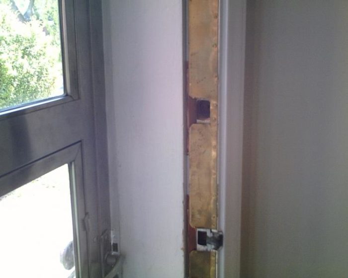

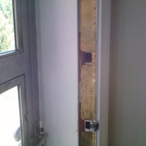

    Here's a photo...
    it's Accurate bronze...I like that it's wide, don't like the lack of the ribs as found on the typical hardware store size (helps the seal)
    Hope you've got a tack hammer...
    You just have to fiddle the lockstrip in, get a nail started, & then set the nails with a punch
