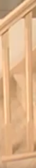

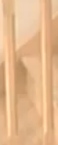

    I watched https://www.youtube.com/watch?v=7cOK-GMkCTs&t=182s. All his tops lined up evenly with the rail and the bottoms lined up with the next tread. That means the mid turned section for the baluster on the leading edged was longer than the mid section of the baluster behind it. See screenshot. How did he get those balusters? Self made? Custom order? Dumb luck? I can find square top balusters but the turned mid point is the same length regardless of baluster length.
