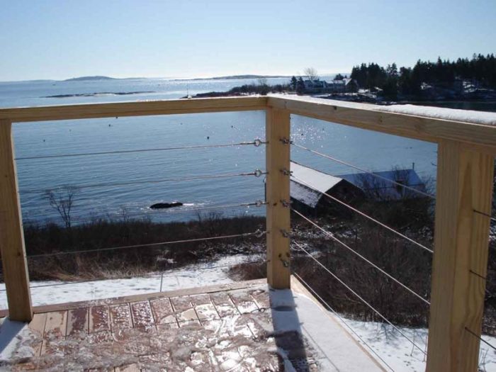

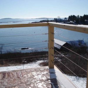

    1. Snort | Mar 13, 2009 10:12pm | #7
      I just did one with cable from these folks:http://www.cablerail.com/contact.shtmlAll we needed was cable and fittings, order showed in less than two weeks.Great system, easy to make up , and nice hardware. We didn't get a lacing needle, would have made things a lot easier.http://www.tvwsolar.com

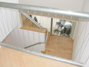

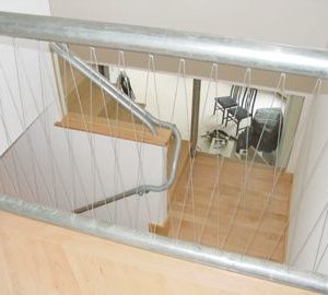

      1. Snort | Mar 20, 2009 02:28am | #22
        Not exactly vertical, but... HO is a Volvo engineer, made it up in their shop.http://www.tvwsolar.com

        1. confused2 | Mar 20, 2009 05:52pm | #25
          Very cool, although not the look we want for our exterior cottage railings. Thx.

      1. Snort | Mar 19, 2009 09:24pm | #20
        On the rail I pictured, we had cedar 2 x 2s w 1/4" sleeves on either side of a 6 x 6 PT post. We drilled holes in the 2xs with a drill press, fence, and a 1/4" hole in the drill press table 3" from the center of the bit.Stuck a 1/4" bit in the hole for a stop and drilled the top hole in all the 2xs. After that, we stuck a block of wood, for a handle, on the business end of a 7/32" bit, and dropped that thru the first hole in the 2x, and into the 1/4" hole in the table. We did that for each successive hole.Next screwed the 2xs to each side the 6 x 6, and and used them for templates. Used a 1/4" split point bit to start holes on each side of the 6x6, took off the templates, and finished boring from each side with a 3/8" auger. If the holes didn't meet, we either redirected the auger, or used a bigger auger.We didn't have a lacing needle, I'll get one the next time.http://www.tvwsolar.com
