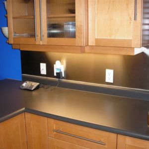

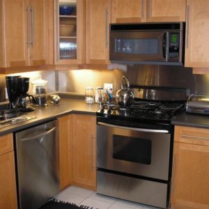

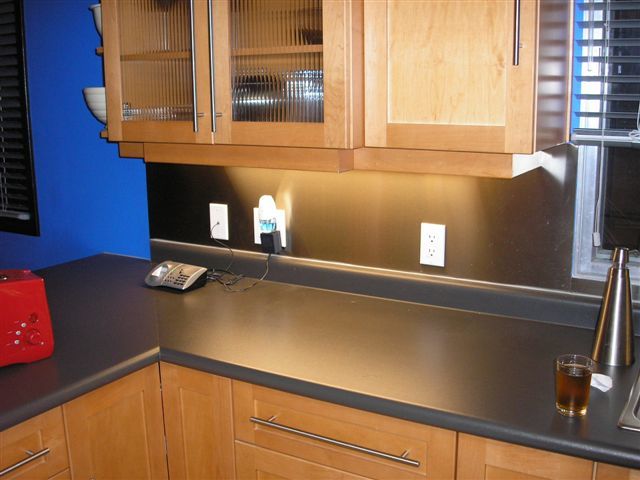

          Hi there...I did the same thing in my kitchen about 2 years ago and have been told it looks 'mint!'.  I had a local metal fabricator supply the material and he cut out all the outlets for me based on my measurements.
          I glued it to simple drywall using an aerosol spray adhesive from 3M called "Hi-Strength 90". This is what the owner recommended and it worked.  You have to be very accurate with this product as it sets up almost instantly so do a couple dry runs first.
          The nice part about this product is that it goes on without creating any 'ripples'  or imperfections that might be visible with a caulking type adhesive that is put on a little too thick.
          I've included some pics..hope this helps.
          Mike
