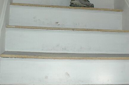

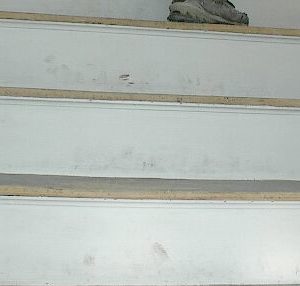

  1. Piffin | Jun 04, 2003 07:50am | #1
    Painted pine, same colour as skirt boards.

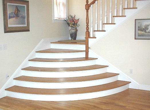

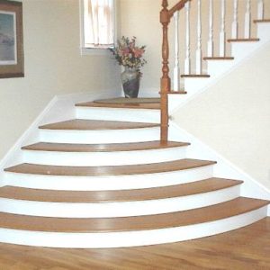

      but, I gotta know, did you make those curved treads? That is sweet set of steps. How, exactly, were they made up?
      I go for the painted risers myself. I think it's easier to paint over heel scuffs than to re-clear finish. EliphIno!

        Billy, I love how it looks, but it wont pass code.  The run is too short and there is no railing.  The run is measured from nose to nose, not nose to riser.  These dam codes make no sense.  But, dont let a stranger walk down the stairs in his socks in the dark who has big feet.
      2. Piffin | Jun 05, 2003 02:47am | #14

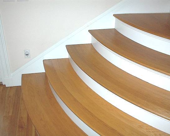

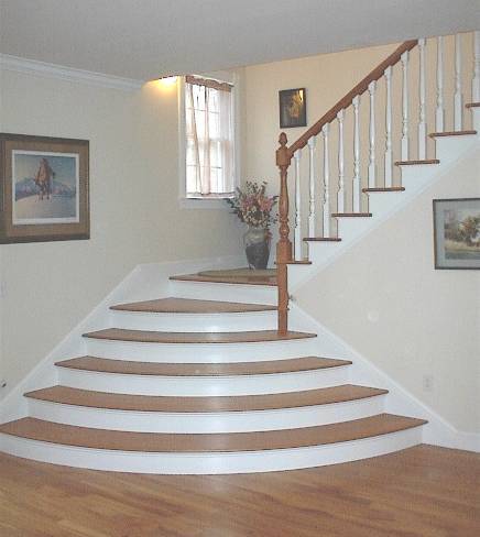

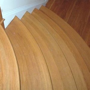

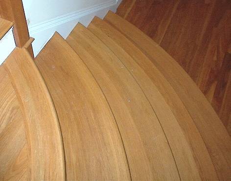

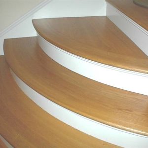

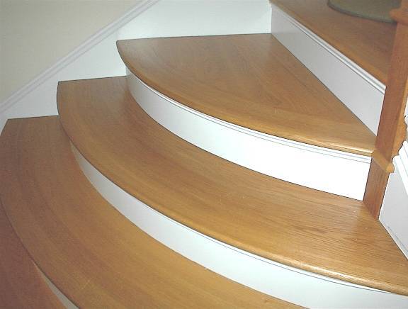

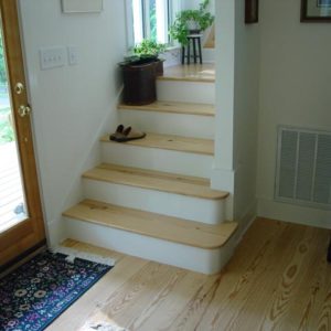

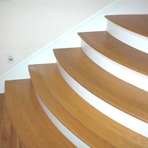

        Yeah, that's by my own hand. As many times as I've posted them here, I'm surprised you haven't seen 'em before.
        5/4 oak ripped to just over 3/8" and planed to just under. Kept track of grain matching. Formed and glued with Titebond. Housed into side trim.

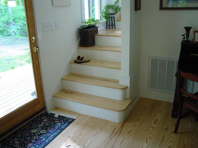

        Looks like Southern Yellow Pine on the floor under yours. This photo shows the rest with the red birch flooring....

          The grain matched curved pieces were what caught my eye. OK, a different form for each tread...how did you keep them flat during glue up? Did you run them through a planer after? How the heck did you lay out the skirts to mortice the housings? Simple, yet elegant work blows me away... EliphIno!
          1. Piffin | Jun 05, 2003 05:52am | #22
            For forms, I drew lines on the plywood subfloor. I have some gigs I dreamed up for varying curves. I will have to photograph them to explain how they look and work, but the strips ift between vertical dowels which plug into holes in other pieces. Those other pieces are backed up by plywood that I can screw down to subfloor as radii on the curve I've drawn about every foot or whatever is needed. That way, I just unscrew and move for the next curve. After seating the strips into the form, I use shims to adjust and clamps to secure.
            The strips do run off a little so I ran each tread through a 15" planner to flaten it.
            I felt like I wanted the skirts dadoed to hold the tension in the curve and keep it all on the same planes. I made the skirts of MDF so it wouldn't move with humidity along the grain.
            To dado the housing on the skirts, I cut them to fit the rough frame steps first. Then I took them out and did my finish fitting of the treads (routered the bullnose already). In doing this, I cut the end off of each tread so I had a mirror shape of where that cut intersected the skirt, accounting for depth of dado. I marked and tabled all these end pieces and used them to trace the dado which I free-handed into the skirts.
            Then I set everything in for a dry run and shaved here and there. When it all worked, I pulled out and set the treads into construction adhesive and used Gorilla glue at the ends into the housing. nailed the skirts to the wall and weighted down the treads over the weekend.
            After that, It was simply running some plys of 1/4" ply for risers and whittling the scotia in.

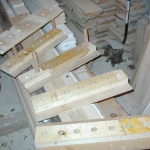

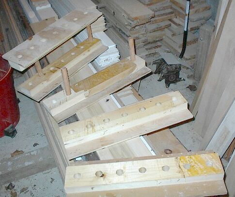

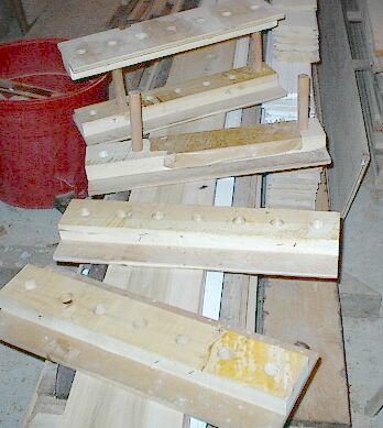

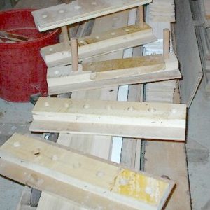

            OK so I made a saw kerf cut first.
            Could be you want to see more...
          4. Piffin | Jun 08, 2003 04:34am | #31
            Here ya go. I went out to the shop and dug out my form pieces for variable curved forming and photographized them for you. I think if you imagine them screwed to a subfloor or table setup, the pictures are self explanatory. Let's call them Piffin plates. ;).

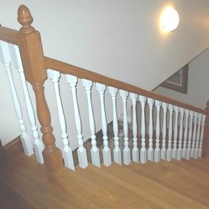

            Handrail - Well, I didn't know Larry back then so this is all I was able to cobble together on my own....

            Ah, pictures. Makes my pea brain not have to work so hard, and, your jigs are pretty darned clever, I might add. Do you know anybody who could help you patent them?<G> EliphIno!
          12. Piffin | Jun 10, 2003 02:24am | #39
            Like that huh? Easier to photo than to describe.
            I've used them for these treads and a couple of curved porch railings after getting tiored of throwing forms away. I made about thirty or fourty of those with dowels from leftover birch ply and some poplar that was too gnarly for cabinet or trim work. See the wax paper on one? It's the backing paper from Bituthyene..

  6. PenobscotMan | Jun 04, 2003 09:47pm | #8
    I like Piffin's suggestion -- I think the contrast between the painted riser/skirtboard and the wood tread looks very sharp. But is white the best color? Might show heel marks.
    1. Piffin | Jun 05, 2003 03:12am | #15
      That's the standard method around here. heels scuffs don't happen on a properly designed stair with overhanging lip and full layout. This photo shows what they look like on a 8"/8" layout with only an inch of lip. You can't walk on them without driving heel into riser because it's so scary..
