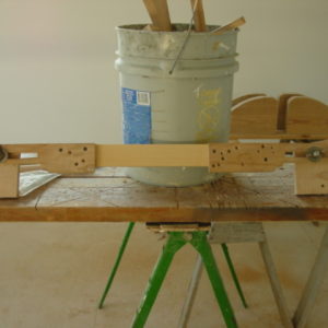

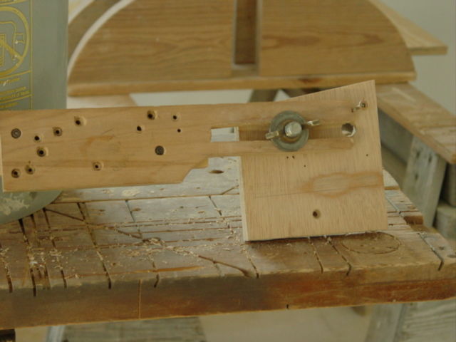

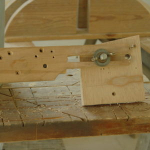

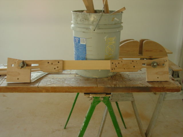

          Your method is in my plan, Pif.  Glue and screw ply treads and risers to the stringers and face over at the end.  Besides using gunned glue, how are you fastening?  Finish nails and putty?  Do you find something like the "stair gage" tool useful in making skirts and treads that fit tight to the skirts?
          1. Piffin | Feb 27, 2003 06:18am | #22
            Yes, stair gauge oats for itself in a couple sets.
          2. Snort | Mar 02, 2003 12:47am | #23
            A stair guage is great. This one is set up for windows, but I just add riser wings or tread wings, and well you probably get the idea... EliphIno!
