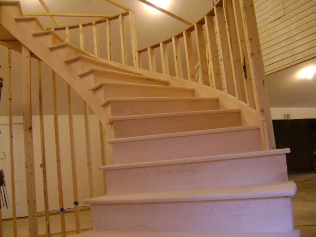

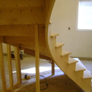

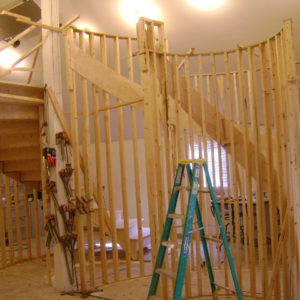

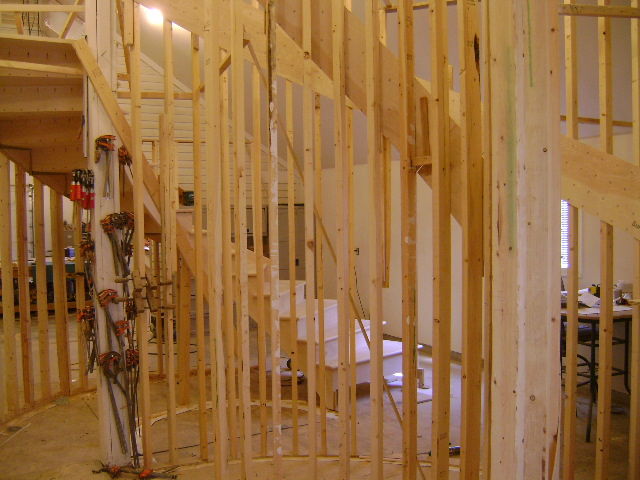

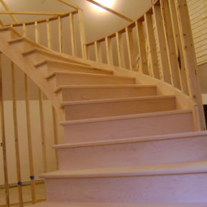

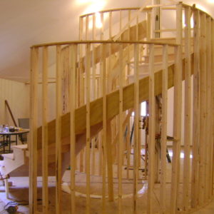

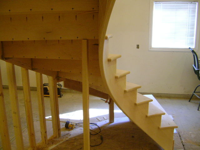

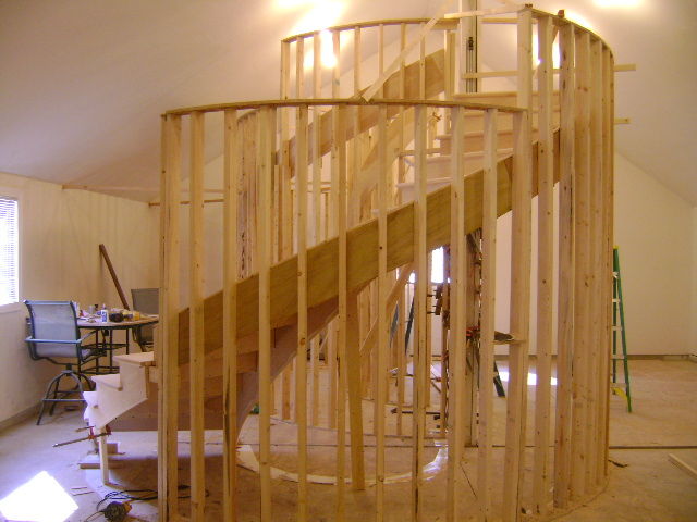

I am setting this maple stairway next week.  I glued up the stringers the end of last week…and spent this week routing and mitering the stringers…and the Thursday and Friday I installed the treads.
Monday I am putting in the starting step and trimming this stairway out.

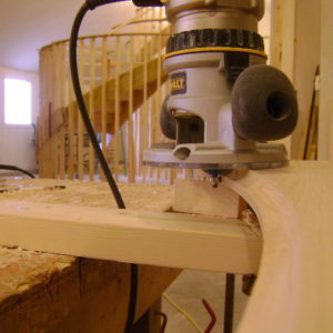

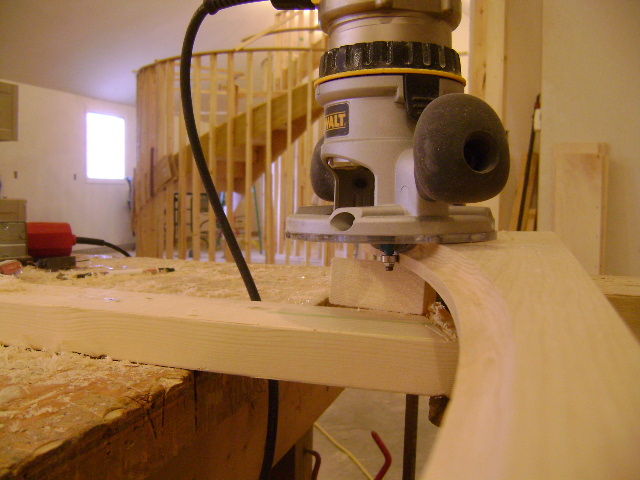

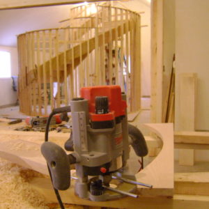

The last 3 pictures show my make shift trammel operation milling out the scotia trim.   That operation only took one hour to mill out the 15 curved scotia trim.

    Thanks Stan, how do you cut the scotia off the blank?

    1. StanFoster | Mar 29, 2009 09:32pm | #3
      snort....real crudely...seriously.   I just hack out about 1/4 inch away from the cove profile....and cut these to a little longer than they need to be.  My trim is already nailed on to the risers and mitered.  I miter the end of the curved scotia...get the angle just right by holding an even reveal against the curved nosing...then I scribe to fit the skirtboard.
      A quick trip to my 12 inch disc sander and I grind down the line.  It fits the first try everytime.....well almost ....I do once inawhile go and rescribe and grind again.

      1. Snort | Mar 30, 2009 03:47am | #5
        hmmm, simple yet effective... but... do you cut it off with a jigsaw or bandsaw?http://www.tvwsolar.com

        1. StanFoster | Mar 30, 2009 04:43am | #6
          snort-   I just cut it out with a jigsaw.

  3. Squash | Mar 30, 2009 02:35am | #4
    Eff...
    Is that, gasp, a Milwaukee router that I see?
