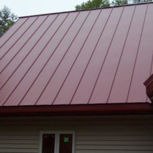

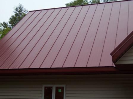

  5. tubby | Dec 19, 2008 12:39am | #15
    I did a standing seam metal roof on my cabin. It was a snap lock version and it's pretty straight forward, especially for somebody who had never installed one before. I think it turned out good and am very happy we did it. Since then we have also done one on my dad's hunting cabin. Here's a couple pics of. And doing a 4/12 pitch would be a snap compared to a 12/12 like our cabin.
