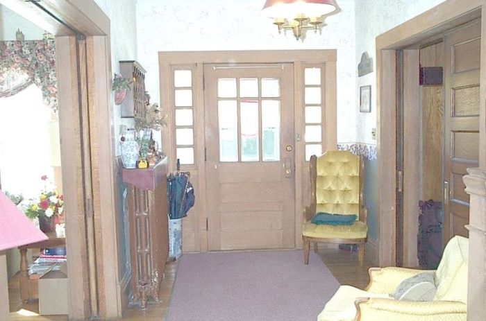

      This is the house we're looking at:
      Don't know how I did it, but the image attached twice. I'll post the link anyway, so the pic should show up in this post.

            BossHog | Nov 14, 2003 05:52pm | #28
            "Hot water is a two-pipe system (for obvious reasons), however there are one-pipe and two-pipe steam systems."
            Thsi system appears to me to only have ONE pipe to each radiator. (Unless I totally missed something when I was there)
            Here's a pic of a radiator in the entry. It appears to only have one pipe.
            Never get into fights with ugly people, they have nothing to lose.
            rjw | Nov 14, 2003 10:48pm | #31
            BH - can't tell from the pic.  Hot water radiators have a little bleeder valve (about the sizew of a tire valve) at one end on the top of the radiatror - steam systems have the steam valve on one end about 1/2 way up.
            I've never seen a 1 pipe hot water system but have heard rumors ....

          4. BungalowJeff | Nov 15, 2003 08:24am | #36
            That's a steam radiator. It is quite large for a foyer, I wonder if it is meant to warm the hall and stairs, etc.? If you buy the house you can always try the steam system. Who knows, maybe you'll be a convert? It is also true that many systems were just poorly designed, although they tended to be over designed in 100-year old houses  because victorians thought open windows were healthy, even in winter.

            BossHog | Nov 15, 2003 03:57pm | #38
            "That's a steam radiator. It is quite large for a foyer, I wonder if it is meant to warm the hall and stairs, etc.?"
            The foyer is quite large, and the stairs take off from there.

            rjw | Nov 15, 2003 09:55pm | #39
            Not arguing here, just wondering how you can tell from the pic - I've always used the bleeder type to determine.
            Is it the valve? The configuration?

            mmoogie | Nov 15, 2003 10:14pm | #40
            Jeff,
            Those radiators look identical to the ones in my parents house, which are hot water.
            I don't know how you can say from that picture if it's steam or water when you can't see the bleeder or if there is a pipe exiting the other end of the radiator.

          8. BungalowJeff | Nov 16, 2003 08:28pm | #41
            Steam radiators from that house's era have a definite fin shape. The different fin shapes are better suited to each type, however it's not a hard rule. For some reason, an art deco hot water radiator was converted for use in my 1901 kitchen.
