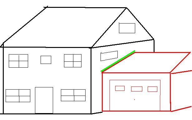

Situation: re-roofing, where the new roof meets the wall siding of a higher section of the house. i.e. lower attached garage roof next to house gable wall. See green area of sketch.
How do you deal with step flashing when the (old) existing shingle siding probably would get damaged if you tried to remove it or pull it away a bit to insert the step flashing?
