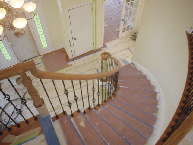

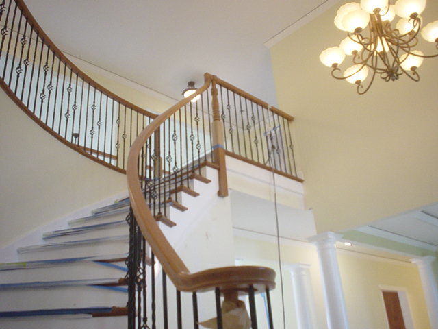

Stan, beautiful work.
I like how the long upper post drops below the skirt and also terminates the nosing.
I may have missed this in other postings, but what type of set-up do you use to mortise the square ballusters into the curved rail?

Gord: The square balusters have a pin top on them which takes a round hole. They are real easy to install.
Calvin and Gord...thanks for the comments. Its nice to be in such fine company as Armin...as I look up to Armins work as the level I would like to achieve. I have to do a balancing act to maintain my lifestyle and be 100% of our family income. This means I have to build a quality stairway..but not excessive quality as I would price myself out of business.
I just build typical curved stairways....and I do feel I am very efficient in getting these built and built nicely. I have been living a very laid back lifestyle for years....and I dont plan on changing anything now as this proves to be working for my demographic area.

Nice blend/joint at the top rail/post connection!
Super detail.

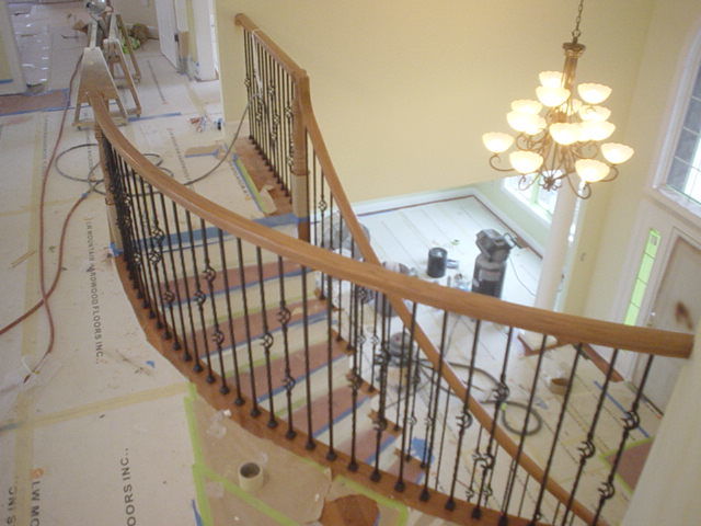

I forgot to mention......I do not particularly like the baluster layout. The owners specifically wanted....single basket/double basket/ followed on the next step with a single twist/double twist.
I was wanting to put the baskets in a diamond pattern....or just alternate baskets with the twists.
Hey...they are the ones paying the bill.....<G>Stan
Hey looks great as usual Stan. It is always interesting to see the different patterns people pick out for the iron ballisters.

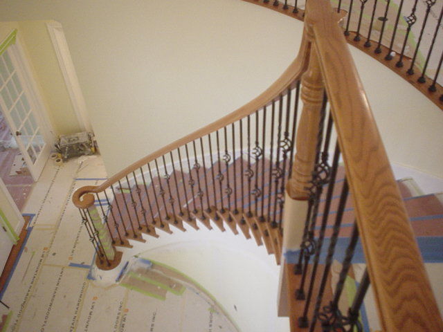

Stan - love your work - don't get me wrong - BUT -
I hate the location of the bottom, relative to the closet door - kinda' picture Scarlett O'Hara sweeping down the graceful curve
Then -
Abrupt left or right, or trip into the off-center closet door
Ughhh!
Forrest: I agree.......they seldom leave enough room for me to design a stairway to fit. I have had theme where the front door just clears the bullnose step.
