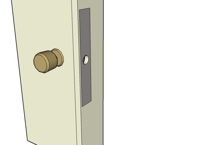

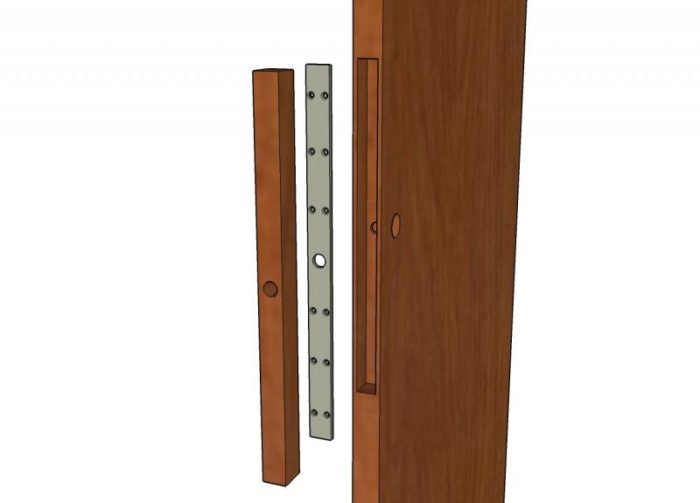

I have 2 quick SU drawings here. The door is one we did years ago on about 1500 doors, 3-0x7-0 90 minute rated. Stainless plate 1/4". Very effective at saving the door. The goal at the time was ensuring that if something broke, it was the jamb - ten bucks - vs the door, several hundred bucks.
The jamb is the same concept. The strength now relies a lot more on the actual lock. So use a good deadbolt. I can tell you just the doors being reinforced dropped the number of doors to repair in a year by about 90%. (This was at a university dorm).

Well it's not like I routed those all out in one week or anything. It took months.
And yes. one method was for a solid cored door - metal insert with a wood filler out of the same wood as the door. The second is a way I've done on what you're talking about - when you have a steel door that you really cant put a plug in like the first example. It at least strengthens the jamb, and the routing is easily done. You can make the piece of stainless with a cutoff saw and a drill press for the hole. The small holes for the strike plate I just drill by hand after its in. (Pilot from the face with a small bit, widen the back out before you install the door with a larger bit so your wood screws can go through the steel and not get mucked up)

RW,Great solutions! I have a few questions for you about it.First one: How come stainless instead of plain steel?Second one: On the jamb reinforcement, it looks like the stainless is mortised in from the back of the jamb. Is is held in by screws, PL Premium, or what?Third one: Was this a solo job? If not, how many guys in the shop/in the dorm?Fourth one: Titebond to glue the door edge blocks over the door plates, or something else?Thanks,

On the dorm, an off site shop fabbed all the stainless. I don't know why that was the pick but it was. Another off site shop set a template for all of the plugs and made them as well. Two guys - myself and another - pulled, routed, filled, yada yada all of the doors, and fixed all the broken jambs and casing along the way.
On the steel in the jamb, I route it flat with a router, coat it with contact adhesive, let it set, coat it again, stick it, and have a couple of countersunk holes on each end (not drawn) that I set screws in. Make sure your length wont pop out the face. Then the strike plate screws go all the way through as well.Real trucks dont have sparkplugs
