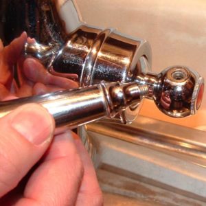

So, a few years ago I decided to buy an expensive kitchen faucet thinking it would last a lifetime. Today without having felt any looseness, the handle just falls off and I see that the machine threads are stripped. When I try to put it back in there is no grip whatsoever – it just spins.
Anybody have an idea how to fix this? My gorilla with hammer option is just to fill it with epoxy but I’m hoping for a cleaner and more permanent fix.
Thanks in advance

    If the female threads are hosed then just about any fix will require disassembling the faucet to get that spindle out.
    If it's the female threads then a Helicoil is probably the "correct" fix, but not easy to pull off, even if you can find the right size Helicoil kit.
    If the female threads are relatively intact then you could cut off the male threads and drill/tap the handle for a stud.

    A stopgap fix would be to put something in the faucet to get some grip for the screw.  Maybe a piece of thin copper wire, fishing line, wire solder, toothpick etc.  A helicoil would be best. But if you're really good there are a number of other good ways to fix it.  Easiest way would be to use a larger screw.  Sometimes you can get a sheetmetal screw to work.

        I never noticed the picture before.  From what I can see, the handle will not need to be unscrewed again.  Therefore I would put a small amount of epoxy on the threads and screw it on.

          I've looked at it a couple times
          and it looks like it's bottomed out.

    Looks like the male thread is what is stripped from your pix.
    Me, I'd put red locktite on it and screw it back together so it just snugs with what torque is left, should be good to go.

    Yeah, I think the cap comes off to remove the whole handle.  The threads look shot on both pieces, But I don't see any real reason to ever have to remove the lever from the handle.

    Try runing it intoa die, then screw it back in. If it gets a good bite on the last couple of turns, remove it and warp it in teflon tape. Or, put a drop of locktite on it and screw it back in and hope for another year or two of sue.

    Thanks for your thoughts everyone. There is no grip in the threads  whatsoever at this point so what I have done as a temporary fix is drive a bolt in so that the faucet is at least functional.
    I may try the epoxy as MarkH suggests although I tend to agree with DanH that with the amount of torque generated by the heavy lever on what is actually a very relatively short portion of male threads this may not last very long. The cause of the problem is likely just that - a very heavy lever working across a very short thread interface - there is actually a lot of depth left in the bowl and if they had added a centimeter of thread this wouldn't have happened,. All the force must have gradually rocked out the threads.
