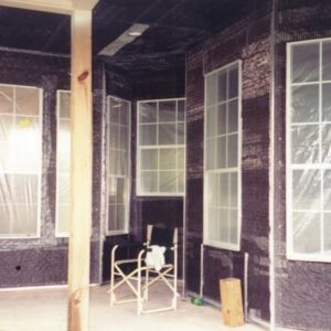

    I just finished my new stucco home. Here is a picture of it. TRhe process of constuction we used was that of .. 1/2 in. plywood, 2 sheets of 15mil felt paper or tar paper, then the 1/4in. hole wire mesh, then came the scratch coat, the brown coat and then the finish which was done with a special kind of paint that had sand in it and was elastic like..... it comes in different colors to choose from...it sopposedly last a long ass time...
