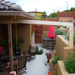

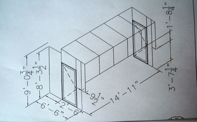

So, once again, in the spirit of “never leaving well enough alone” I’d like to add a sunroom to my place. I want the room to be a 4-season affair, super snug and dry and with the most glass that I can get away with. It’ll be a fairly easy build – not high in the air, a lean-to style. I’d like a wood finish on the inside and aluminum on the exterior. Pretty standard stuff.
So, I search the internet (as our local glass shops aren’t interested) and run it by one company that advertises a lot. Well, holy
! Nearly $ 20,000 (supplied only) for some glass and aluminum framing! C’mon, what the heck am I missing? Have you fellas ever done one of these? If so, did you build the superstructure yourself and then order low-E glass? I’m quite ticked off at the price and I really would like some feedback from any of you builders that have constructed such a thing.
I’ve attached a couple of photos to better show what I’m intending to do. Thanks to all in advance.
Cheers!
Ken

    OK, just looked at the pics... that should be very inexspensive to have done, labor and material.  You are obviosly dealing with the wrong people.
    You can skip the aluminum framework and build out of cedar timbers or another similar wood and add glass panes yourself.  You can order the insulated glass panels from a glass supplier for a good price.

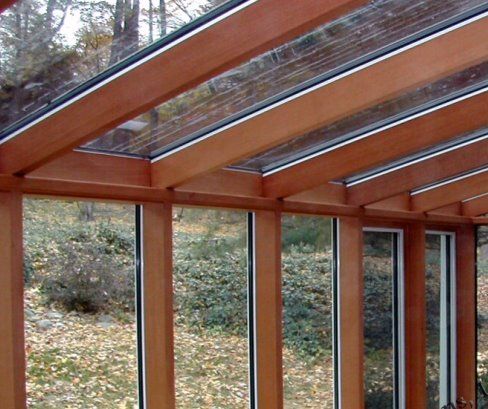

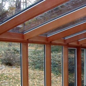

      I mean, in the ICI sector an architect would spec this and a millwork shop & glass house would come up with a workable combo, right? Why is it that as soon as it's "residential" the details go down while the price goes up? Double-glazed triple low-E glass isn't a new invention. Is it because it has to be a heavier gauge because it creates a roof? I've seen the kind of sunroom that you've mentioned (Taco Bell, etc.) and they've got thermally-broken aluminum framing and sealed units and the work just fine. The only thing is, they're butt-ugly. Too commercial looking for a home situation. So, I thought I'd have a wood component on the inside. Is this asking too much? Sigh.Cheers,

        In the past I've built these things for different clients.......I used cedar inside like the pictures.... outside I had my glass guy come over, measure, make and install the glass for a hell of a lot less expensive than what you're talking about.......secret......it's a lot better to have the glass guy do ALL glass......cause he delivers/installs/fixes what he breaks.I used a tape (maybe 4" across with really sticky rubber on one side and aluminum foil on the other (this is the tape Lindal Cedar Homes uses on their sun rooms) It worked as the water/weather guard.......then I covered the tape with cedar 1x ........clear cedar is the only way to go with all that glass cause, well there are lots of reasons.....bent nails hitting knots and deflecting into a glass panel is one.........

    I would suggest you start your component pricing here:
    http://www.conservationtechnology.com/downloads/TimberGlazingSections.pdf
    Then the :
    Glass shop (overhead glazing must be safety glass IIRC)
    Lumber yard for clear cedar/redwood/Fir
    Electrician for vent fan/humidistat
    Design/Engineering costs
    Labor for project
    Lumber Yard/Batch Plant/ Paint Store etc. for Materials for everthing not included in frame and glazing.
    When you are done with that list and totaled it up I think you may just be surprised .
