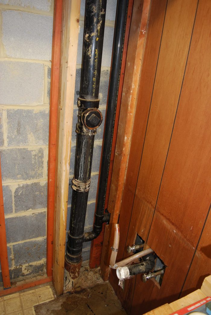

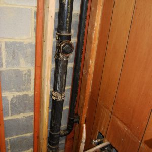

Opened up part of my basement wall (replacing paneling with drywall, with some insulation and other upgrades)

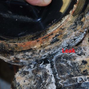

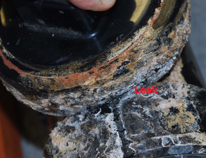

found a leak in the ABS stack.
The old paneling had been installed, hiding the clean out, for 30 years or so.
Must have had issues before then, since there is a rubber joint installed
I plan to replace from above the cleanout to the existing joint with PVC.
This 3 inch vertical stack carries waste from the half bath on the first floor, and a full bath on the second.
How much should I worry about supporting the ABS while I cut it and insert the new pipe?
Any other free advice?

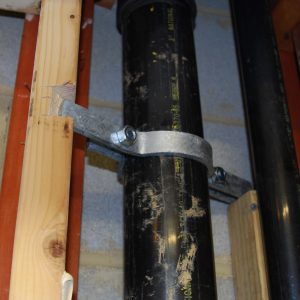

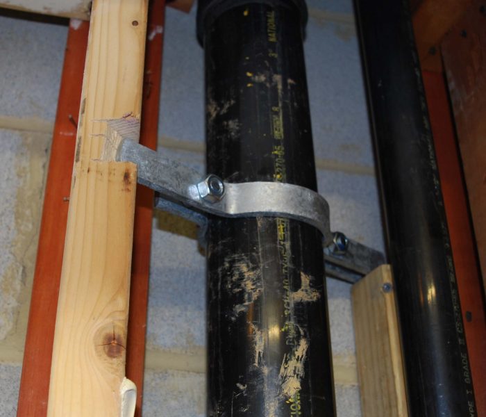

    decided a riser clamp was worthwhile.
    notched the front stud, added a short 2x3 on the right.
    cut the back half of the clamp to fit it around the back of the pipe.
    Snug (old guy finger tight) plus about a flat, and some locktite to keep the nut where it is on the bolt.
    1. andy_engel | Oct 31, 2020 03:51pm | #2
      Nicely done.
