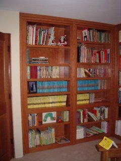

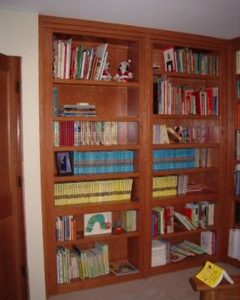

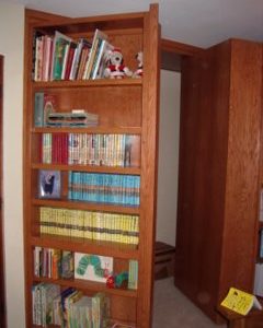

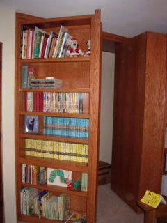

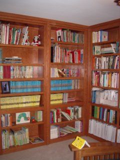

I didn’t design or build these. Just installed. I think they’re really cool.

      Floor sloping down is an advantage as they are supported by the pivots with no exposed hardware or wheels. The pivots are 3/8" althread built into cabinets. The bottom of the allthread has an acorn nut on it that rests in a tapered hole in a piece of metal hardware screwed to the floor. The top althread goes into a metal sleeve in the 3/4" oak plywood on the ceiling. The only adjustment is up and down by turning nuts with washers that are on the althread above and below solid oak blocks in the cabinets.Smile. It could be worse. You could be me working for you.

        1. mikeys | Feb 18, 2004 05:29pm | #4
          A block of oak on ceiling with magnetic catches. also chain to prevent opening too far.Smile. It could be worse. You could be me working for you.
