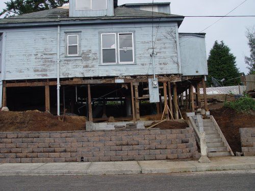

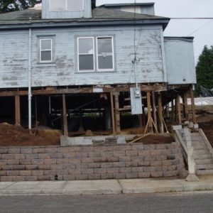

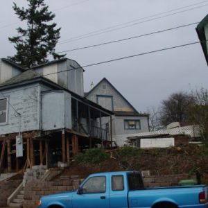

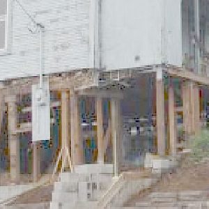

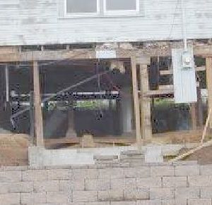

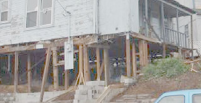

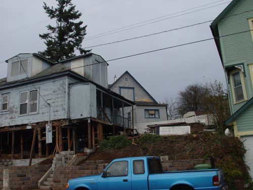

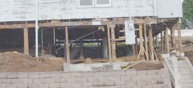

    This is a little unrelated to your offering, but I've been doing a remodel/addition in an older neighborhood (100 to 120 yr. old homes....old for here on the West coast, anyway).  A lot of these houses were built by the owners;  loggers, fishermen, millworkers, dockworkers, etc., with little regard for engineering or the kind of foundations put down today.
    A couple blocks from my project is an old two story house being worked on by an elderly man and his two sons.  Early on in their effort, before I took any pictures, it was absolutely scary to see what they were doing;  rickety cribbing, excavating with pick and shovels well underneath the structure....I figured a good gust of wind might bring the whole thing down.
    The house in the pictures has been vacant for awhile. It was built on a hillside on a primitive post and beam "foundation" with the posts being an assortment of logs and what I assume were salvaged timbers.  Under the center of the house, one of the girders was supported midspan by a tree stump.
    During the "foundation" renovation, the tree stump was dug out by hand, leaving about 2/3rds of the main floor stucture to visibly sag....until they finally got it jacked into place and new posts in, some setting on 12" concrete pier blocks.
    I assume it is their own fixer upper, because they've been at it for about three months now and it's obvious that, once the understructure is in shape, there is quite a task ahead to restore the rest of the house.
