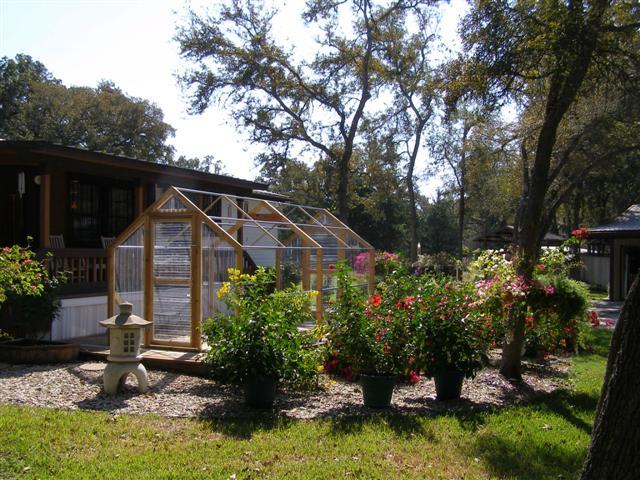

A 8X20 temporary greenhouse built on my front deck. Gonna use it to test some design ideas for a larger 12X40 structure built from 3″ square tube and all polycarbonate.
This will be covered with 6mil plastic. All half lap construction. Polycarbonate on the front and back. 1″ EMT. Designed to use all 10′ materials. Takes two ten foot 2×4’s to make each frame less the door. Capture strips at the tops and sides of the frames. Obviously not desigened for snow load.
Gotta have someplace to keep 30+ Boganvillas, hibiscus, and other assorted tropicals.
Cover it with plastic in a few days.

This is just really an experiment. I already have a 10 X 12 in back that's built on the ground, and I want to see what the heat loss is by placing one on a deck.

I did find out that erecting it on a deck doesn't give you the advantage of the heat trapped in the ground, so it takes more to warm it.
Without sealing it at the corrugations and the base, i can imagine heating it, as you were expecting to do, would be difficult.
It occurred to me that you could cap the corrugated area with a piece of wood padded with foam. IOW, the foam would seal the cut edge instead of from the face of the sheet.
Yes, you could do that, however, the fascia structure is the same thickness as the corragations on the polycarbonate, and tend to mate up well. In a super cold climate as you are in, it would make a difference. Here, not so much. I'm playing with the idea of doing them out of 4" metal purlin with a wood stapling strip. These could be set in the ground permanently and only replace the stapling strips and plastic.

Here's a current shot of the GH and one from the interior. Had to move the plants inside already due to forecast of frost to freeze coming monday when I'm out of town.
Where are you located? A lot about the use of your GH, will as you may know, depend somewhat on orientation. Not much choice on mine but it is on a NE SE axis on the south side of the shed which houses the door and buffers north wind.
We're located just east of Austin, Texas, in Bastrop County. No freezes predicted here.
Greenhouses down here have to be usable all the time. The permanent one I plan on building will be built under deciduous trees (water elms) and have the 80% shade cloth to moderate the summer temps so we can propagate Bouganvillas and Hibiscus. We only get about a couple of weeks of freezing temps, plus a few frosts, so heating can be relatively cheap. My 10X12 in back is heated with a milk-barn heater, and is under a deciduous Post Oak, but even then it gets over 120 degrees inside before the fan kicks in during the summer. Might heat this one with a small propane for really cold nights, and a milk-barn heater to keep it up in the '40's.
In that second picture, that's not Romex I see hanging down is it? ;-)
Worst. at the moment it's the cord from a temporary fan in the roof. Ya I know...bzzzzt.
