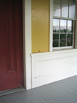

Having the panel on the same plane as the door architrave (which itself is just a flat board) is also repeated on the front porch of the same house. Photo attached on next message.

Here's the front porch panel. Panel frame overlaps door architrave.

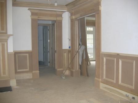

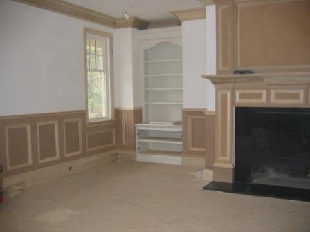

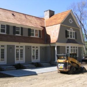

Here's one with the plinth block idea. I would just do the wainscoting without the base, I think in most cases it will look the best. If the house is very high end and all the trim, size of rooms and luxury of the house are there then I would do the baseboard. I left the picture large so you can see the detail. I also added a compressed file for the dial ups
Edited 6/22/2006 8:08 pm ET by DDay
Nice place, ya got more pix

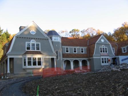

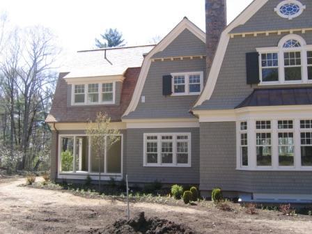

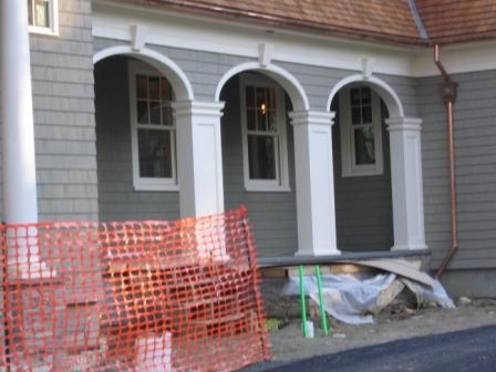

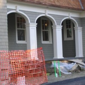

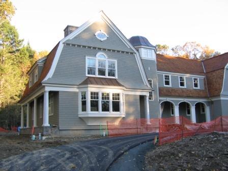

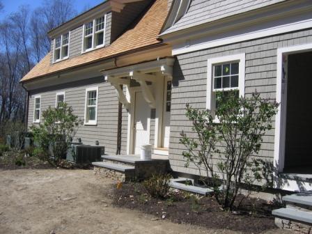

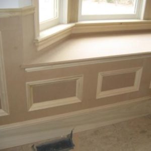

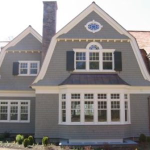

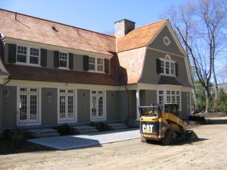

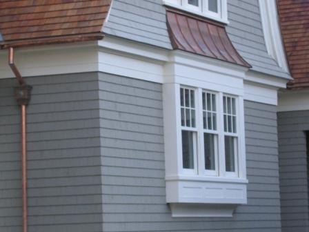

Not my place but here's a few more pics. I met the builder last year when they were framing it, it will be finished in another month. I think its about $5.5 to $6m. Very nice workmanship and in the nicest and most expensive town in MA, Weston. I end up seeing these when I'm mountain biking through trails, so I take a few pic's here and there to get a few ideas.
This house has lots of copper, gutter, flashing, etc. and in the front pic you can see the large dome of copper.
