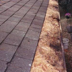

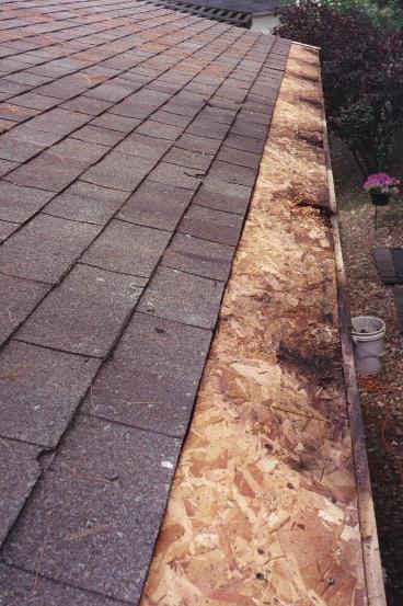

Not that there seems to be any real need to make the case, but…
This roof had no starter shingles installed. There was tar paper, but it had long ago given up the ghost.
You can see the rot every three feet.
Rich Beckman

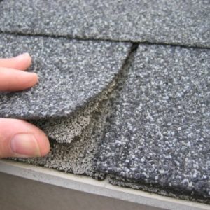

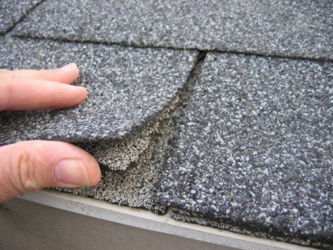

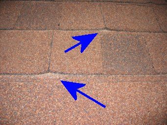

      rjw | Oct 05, 2003 12:52pm | #11
      Ever see a roof WITH starter course----only the starter course isn't offset from the first course----so there STILL is a leak every 3 feet?
      Saw one the other day on a nail over with no starter on the first layer!- I figure about 10 more years.
      BTW what causes the bidsmoth beak/ridge between two shingles as in the second picture I've attached, img_1192sa?
      _______________________
      Why Don't Blind People Like To Sky Dive?
      Because it scares the bejabbers out of the dog
      Your mileage may vary ....
      Edited 10/5/2003 5:54:28 AM ET by Bob Walker
      1. xMikeSmith | Oct 05, 2003 01:21pm | #14
        either mfr's defect, or installer's defect... my guess, the 2d... they were laid too tightMike Smith   Rhode Island : Design / Build / Repair / Restore
  6. VinceCarbone | Oct 05, 2003 02:18pm | #15
    Rich,
    What did they do use 3' strips of paper? I would seem you'd have rot every foot(each rain grove) or maybe they used some type of gutter hanger attached to the top of the roof.
    Vince Carbone
    Riverside Builders Franklin NY ICQ #47917652
  7. HeavyDuty | Oct 05, 2003 09:36pm | #17
    Vince had his point. If starter shingles were missing, why didn't the rot show up every foot?
    May be we can start a folder "what's your diagnosis" or "case of the week" so people can exercise their brain a little bit and learn something along the way.
    Tom
    1. Piffin | Oct 06, 2003 12:33am | #18
      architectural shingles don't have a crotch line cutout every foot.
      Then there are metric sized three tabs that have it every 13" or so.
      1. HeavyDuty | Oct 06, 2003 01:00am | #19
        For some reason I always thought that was three tab in the picture. Now I went back to look at it again and yes you're right, it's architectural. Where are my glasses...
        Tom
        1. Piffin | Oct 06, 2003 01:05am | #20
          here they are - I was sittin on them
          LOL.
          1. HeavyDuty | Oct 06, 2003 01:09am | #21
            Are they broken? Ouch.
            IMERC | Oct 06, 2003 01:41am | #22
            Not yet . Just a minuet...
        RichBeckman | Oct 06, 2003 02:30am | #23
        "architectural shingles don't have a crotch line cutout every foot."
        Piffen's got it. The pic I posted easily passes for three tab at first glance. But the shingles are architectural. It confused me for a moment when I was posting it.
        "Wait! Wouldn't the rot be every foot?? What don't I remember here??"!!!
        Rich Beckman
        Another day, another tool.
