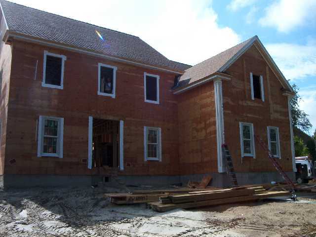

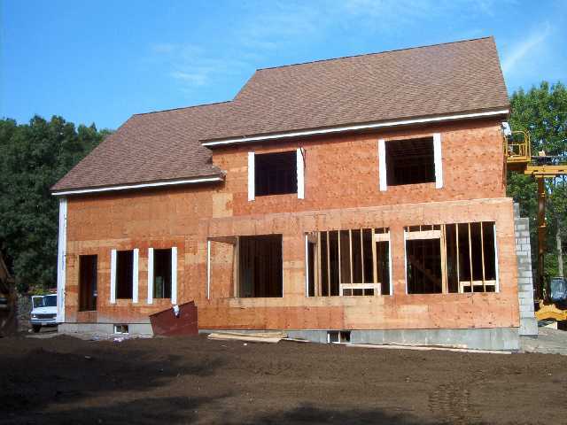

dieselpig | Posted in Photo Gallery on August 17, 2005 02:41am

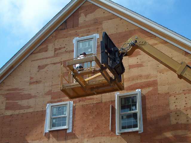

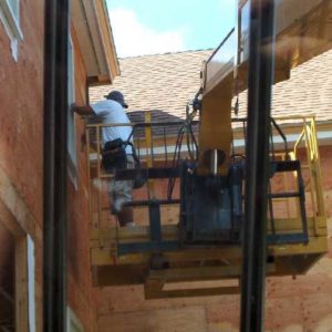

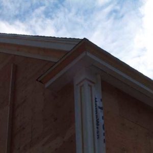

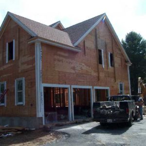

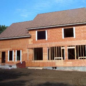

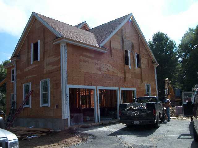

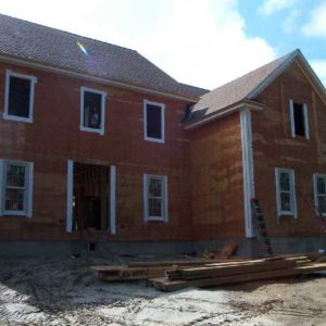

Alright Tim, you asked for pics of the current frame… here’s a few.  It’s not very sexy yet, but I think the farmer’s porches we are starting tomorrow will dress it up nicely.  It will run across the front, down the left side, and it’s roof will tie in with the roof of the four season porch on the back.  The porch is about 8′ and the four season room is 10′ so that will leave me with a bastard hip on one corner to mix things up a bit.
I’ll take some pics of the inside tomorrow if I don’t space out.  It’s hiding a 24″ x 34′ quadruple ridge beam in there and a couple cool ceilings.  Nothing of the calibur of the ceilings in your last article, but different none the less.

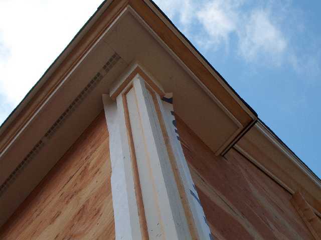

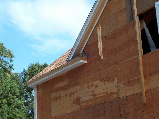

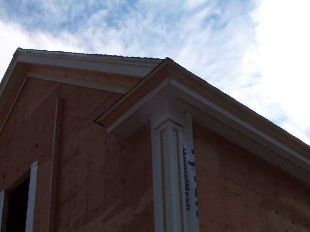

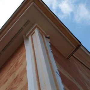

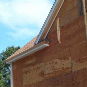

The trim has been the most interesting part of the frame.  That is 5 1/2″ crown that runs down the rakes, across all the fascia and wraps around the 44″ returns.

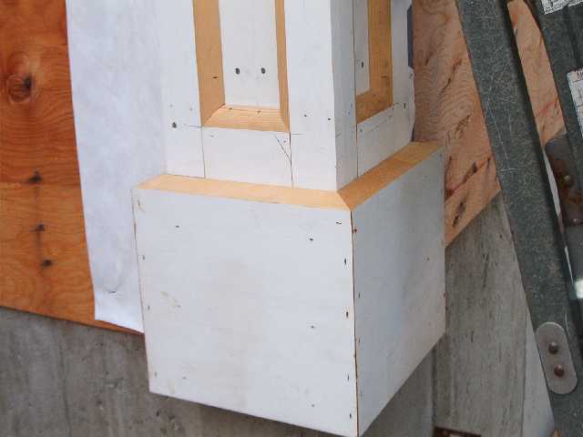

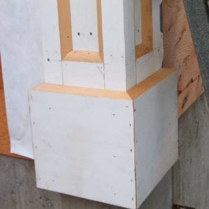

I’ll be building out the columns for the farmer’s porch to match the cornerboard detail.  15 of them IIRC.  Should be a nice change of pace.

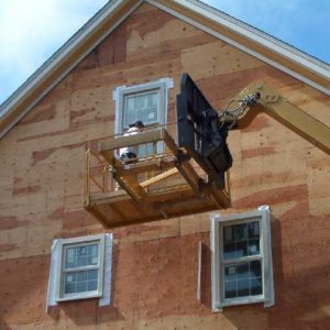

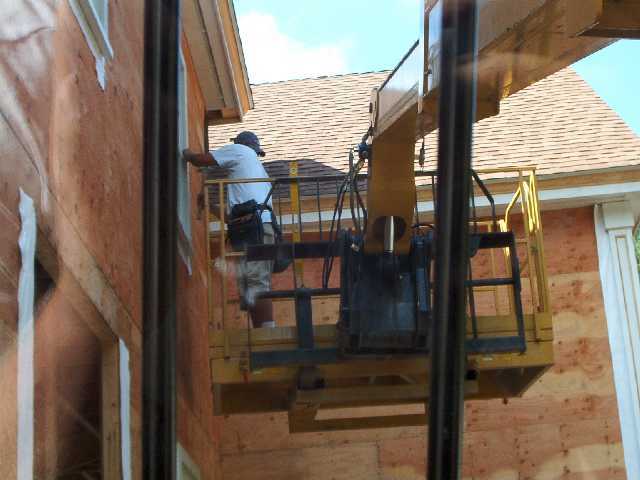

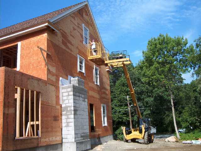

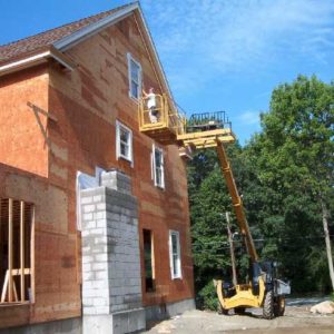

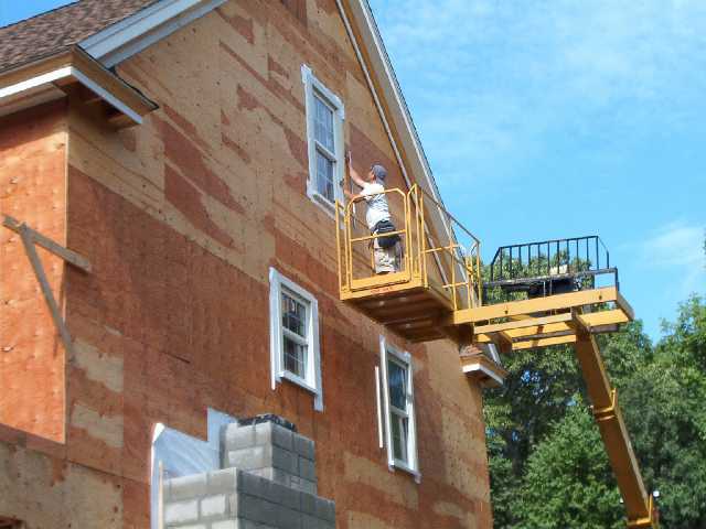

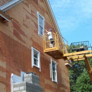

Like I said… it’s not very sexy, so I’ll include some shots of the us using the machine today…. that’s always sexy!!
Oh yeah…. and don’t ask about the Tyvek around the windows…. sometimes I just do what I’m told cuz it ain’t worth the argument.  FWIW, this is the house that started with the oversized fountation.
I’ll get some shots of the porches as they progress.  I’m happy to have finished the main house as the mechanicals will be starting later this week…. I hate tripping over other subs!  😉
    Timuhler | Aug 17, 2005 03:06am | #1
    Brian,
    Nice work.  I can't believe how clean the framing always looks on your sites.  That man box looks pretty slick.  Are you in love?  Every time I avoid hauling a heavy window, or we sheathe a gable way high in the air, I fall in love all over again :-)
    Your trim looks really good.  You are my argument that framers CAN do trim :-)  Nice work and you would never know the foundation was all over the place :-)
      dieselpig | Aug 17, 2005 03:27am | #4
      Glad you like the trim, I kinda enjoy it sometimes.  It's a good change of pace.  You can't see it too well in the pictures, but I ran a router with a cove bit down the 1x8 rakes as well as the 1x3 shadow.  It give it a couple extra shadow lines and looks really cool without adding the expense of more molding.   I'll try and get a close up tomorrow.
      Yeah, I gotta agree.... the work platform is heaven sent.  I love work tools for the forklift.... always money well spent.
      1. timkline | Aug 17, 2005 04:09am | #5
        is the platform a custom job ?
         carpenter in transition
          dieselpig | Aug 17, 2005 04:17am | #7
          Nope.  It's built by ForkMate.  United Rentals is a national company and is a distributer of their products, that's where I got mine.  They have a larger 14' platform as well as an 8'er that doesn't swivel like mine.
          I chose the swivel platform because we get some pretty tight sites sometimes where I can't get the machine in head on.  I think it's a pretty slick solution.  It ran me about $2800 including freight and jobsite delivery.

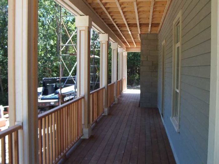

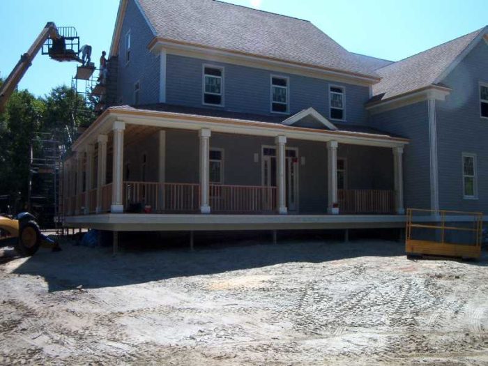

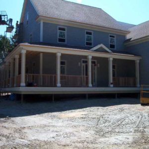

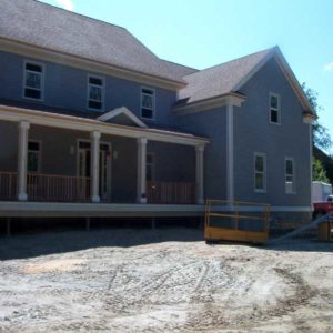

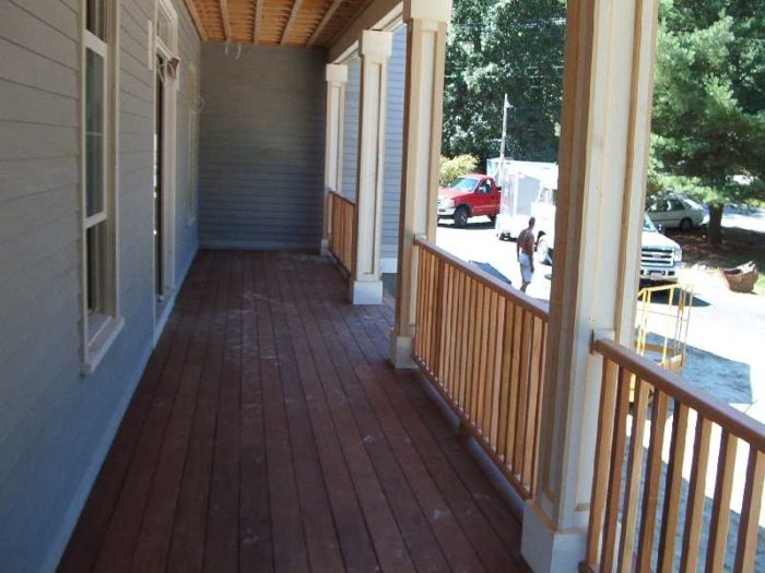

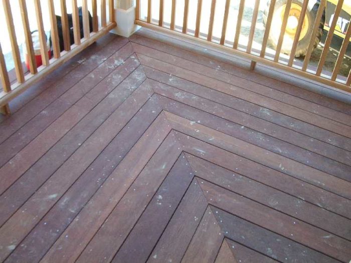

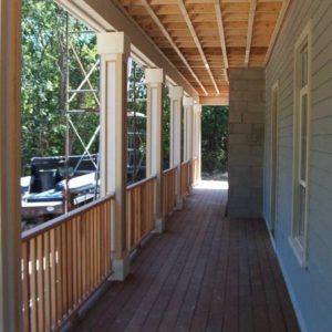

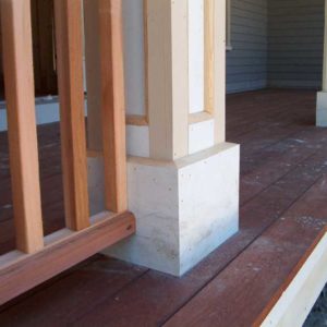

      dieselpig | Sep 08, 2005 05:39am | #38

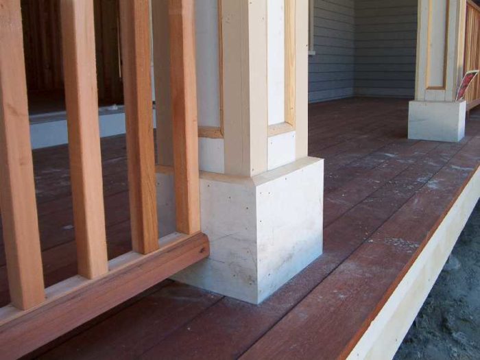

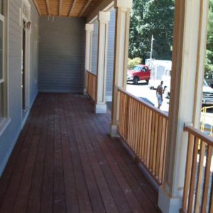

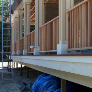

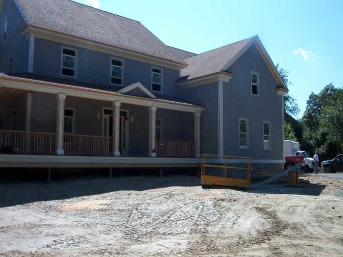

      Hi Tim.  We finally wrapped up that frame at noon time on Friday.  6 weeks to frame the house and 3 weeks to build the porches.  Nuts, huh?  We didn't break any speed records on this one, but it's a great frame, I made good money, and the builder is phsyched.  Can't ask for much more than that, right?  I gave my guys each a $500 bonus for this frame because they did such a great job for me.
      Anyway, the columns took me about 2 hrs each and there's 11 of them.  I'll bet a real trim guy coulda knocked em out in about 45 minutes or less, but I'm barely a framer never mind a trim guy!  LOL.  We also made the railing stock ourselves and all the mahoghany decking was predrilled and screwed down with SS trim head screws.  Every screw is exactly 1" from the edge of the plank and the rows of trim heads are dead on straight.  I love it!
      1. DanT | Sep 08, 2005 12:53pm | #39
        Great work.  Great pictures.  I really like the one of the scaffold.  I mean how often is it that you see that kind of scaffold.  Man, blue too!  Usually around here it is plain old yellow, but blue!  And the planks, wow!  Surprised they weren't stained.  LOL.  Nice work my friend.  DanT
          dieselpig | Sep 08, 2005 01:45pm | #40
          Glad you like the staging.  I thought you might.  I'll be sure and ask the mason where he got it for you.

  3. ravz | Aug 18, 2005 04:42pm | #8
    What material is being used for the corner columns?  Is that aztec?  I have a feeling it isnt, because it seems the white colour is only a coating? is it preprimed ?
      dieselpig | Aug 19, 2005 01:25am | #9
      Just plain old pre-primed schwag.

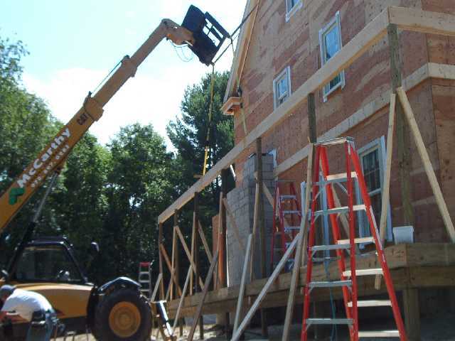

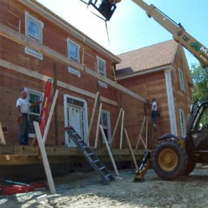

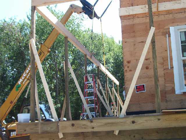

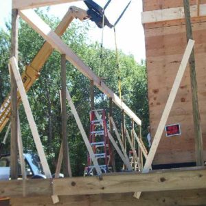

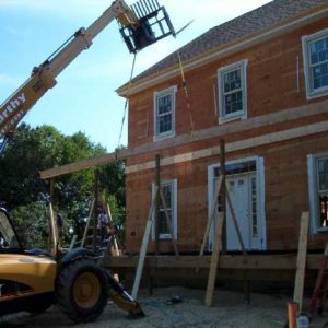

    dieselpig | Aug 20, 2005 01:40am | #16

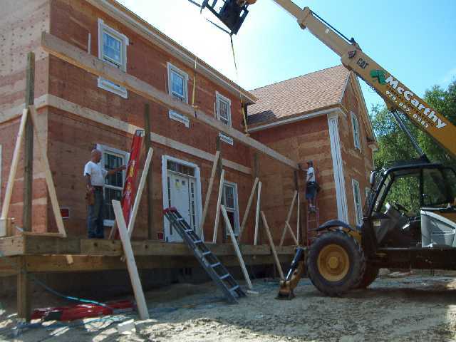

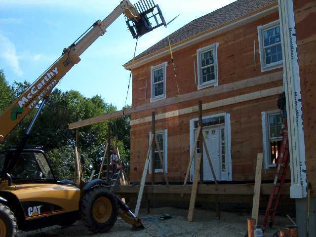

    If anyone's interested....

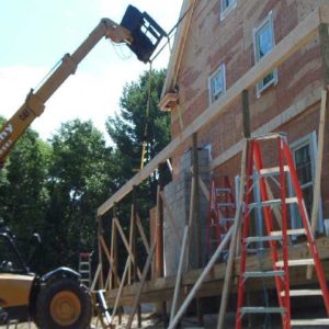

    Here's some shots from today of us putting the machine to good use.  The beam across the front of the house is 42' long, triple 2x10 and the beam down the side is also a triple 2x10 at 55' long.
    We built them right there at the front of the porch, across the joists.  This gave us a nice flat level place to build the beams, ensuring that they would be as straight possible, minimizing how much we'd have to rassle it straight before joisting.
    When I set it on the posts, there was actually only one post where the crown held it off the post about 1/4".  Once we had it adequately braced, I used the machine to nudge the beam down tight to that post and nailed it off.  Sweet.
    The machine was, once again, the hero of the day.  Rasselin' that big bertha beam into place with just the three of us would have been an impossible task, and building it in place up on the posts would have been a perfectly miserable experience.
    Another day where the machine gets voted MVP.
    By next week, I'm hoping to have all those 4x4's packed out and trimmed out to match the corner boards.  I dunno though... that's an awful lot of posts.  We're also installing the 5/4 x 6 mahoghany decking and trimming out the framing as well.  Oh yeah.... I haven't even cut, framed, sheathed, or trimmed the roof yet either.  All right... maybe 10 days?
    Two weeks tops.  ;)

      I think that's cheating.  ;-)

    Looks great, couple of questions.
    Whats the siding going to be?  wouldn't it be easier to wrap the house before doing the corners and windows?
    and last, why plain old pine for the exterior trim?  guessing you didn't spec it?

      Hi Neil,
      The siding is cedar clapboards.  All materials were specced by the builder.  I don't supply or spec any materials on 99% of my jobs.... just supply labor.  I try to advise, but I don't really push unless asked.
      You are correct.  It certainly would have been easier to wrap the entire house while the walls are on the deck or at least before applying trim or siding or windows.  But, "why should I pay you to Tyvek it when the sider will  do it for nothing?".
      Good questions dude, thanks.  While I don't always agree with how I build my frames, or what materials I use, the truth is that sometimes I just have to grin and bear it.  Sometimes it's better for me to just not argue with the guy who's writing the checks, you know?  In the big picture, who installs the Tyvek and when, isn't really that big a deal.  I don't believe it will really effect the quality or integrity of the building, so why argue?

        Yeah, but the builder is an idiot....
        "the siding guys will run tyveck for free"
        unhunh... guess I should say either the builder or siding sub is an idiot... cause someone is paying for it somewhere, I'd think the builder would be smart enough to realize even if  the sub says it's free, that he is paying for it.
        The most efficent way to do something is usualy cheapest but whatever minor point.
        Isn't tyveck incorrect under cedar anyway?
        If it didn't really effect the quality of the house or my paycheck I wouldn't bitch either though...

          Yes Neil, I've heard that the tannins in cedar can break down some of the properties of Tyvek.  Not sure if that applies to pre-primed cedar siding which is all I ever really see anyone use around here.
          Honestly, I don't know enough about cedar or Tyvek to really know the answer.
          You could be right... the builder could be paying for the wrap through the sider anyway.  All the more reason to not pay me to do it.  But either way, this particular builder is far from being an idiot.  He's got bigger fish to fry than worrying about who is hanging the housewrap.  I think the important thing is that it gets hung.... not who hangs it.
            Personally it's a gigantic nuisance for me to do it anyway.  It's not like it really brings in any real dough, and it forces me to get to places I normally wouldn't even go to during some frames.  What I mean is, there are some places (corners and short walls particularly) that can't be properly wrapped while the walls are laying on the deck.  Now we have to go back and wrap those corners from either a ladder (PIA) or the machine which ties up not only the machine, but also two warm bodies that could be spending their time and my money in a more productive way somewhere else on the frame.
          In my opinion, it's better left to the siders anyway.  They need to stage every inch of the house anyway to do their job.  Pump jacks are the perfect opportunity to efficiently and safely install wrap.
          I guess their is no perfect answer.  And, like I said Neil... I'm far from perfect.  Unfortunatly not everything I build is worthy of the pages of FHB.  But I think I build a good deal of "middle of the road" type houses.  Average size and finishes, if you will.  Therefore, I would assume that many of the folks who frequent the forum are working on similar projects and would appreciate the opportunity to compare apples to apples rather than try to compare their work to the  projects that grace the pages of most magazines with their rediculous budgets and super high-end finishes.
          But I could be wrong.  Wouldn't be the first time.
