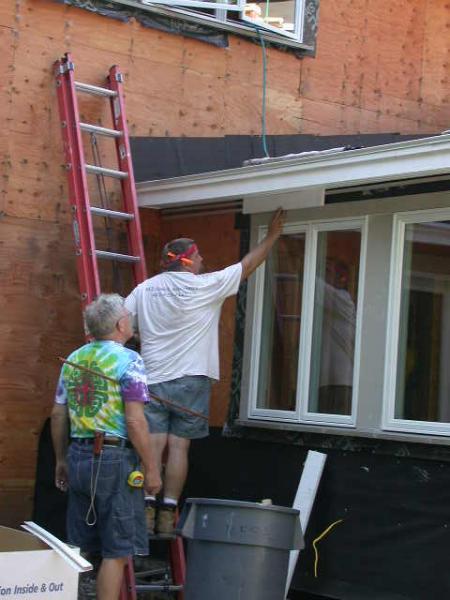

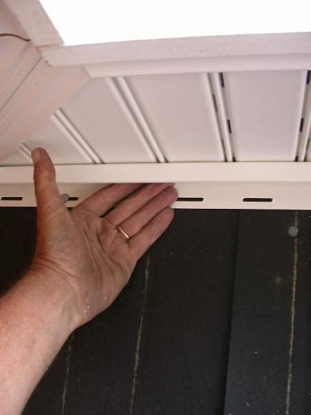

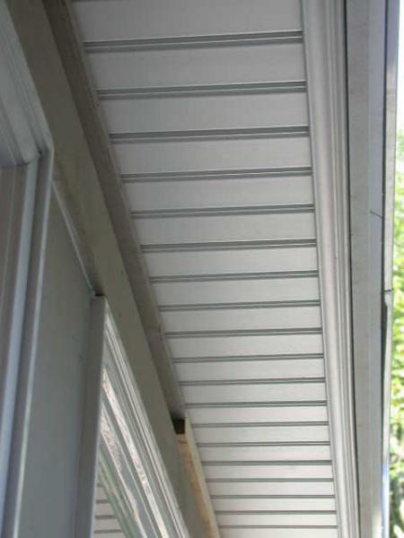

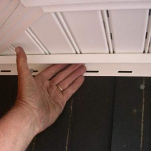

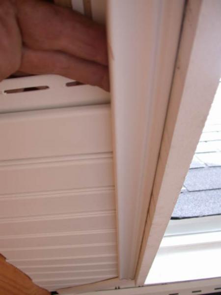

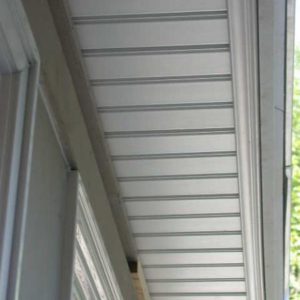

          8. MikeSmith | Jul 12, 2005 03:31am | #33
            gene.. we use a lot of soffit.... my favorite is Alcoa Probead.. either vented or non-vented.. the vents are concealed in the bead slits
            here's a pic with a 2x4 subfascia... a 1x8 Azek fascia... 2" shadow board..
            the soffit is applied to furring nailed to the soffit framing.. so  3.5" sub-fascia...+ 3/4 " furring.. + 5/8 " colonial j-mould  ( 3/8" Probead soffit )
            still leaves a 3/4 reveal..
            Edited 7/11/2005 8:33 pm ET by Mike Smith

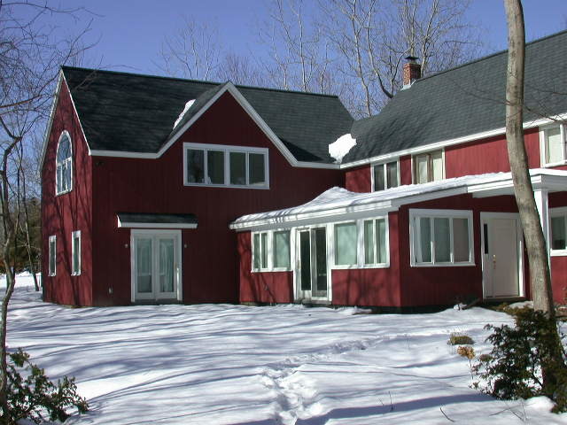

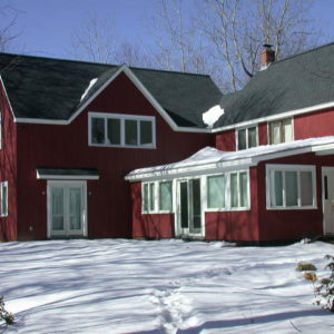

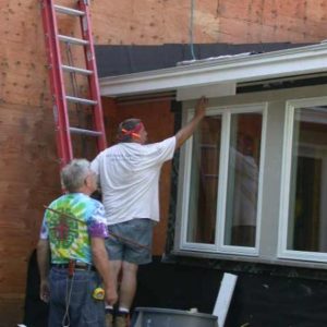

          9. MikeSmith | Jul 12, 2005 03:36am | #34
            here's what the finished job looks likeMike Smith Rhode Island : Design / Build / Repair / Restore
          10. davidmeiland | Jul 15, 2005 09:18pm | #38
            Are you the one in the Grateful Dead shirt?!
          11. MikeSmith | Jul 16, 2005 02:49am | #39
            no... that's the owner  ... and Roy on the ladder...
            i'm running the  camera, remember ?Mike Smith Rhode Island : Design / Build / Repair / Restore
