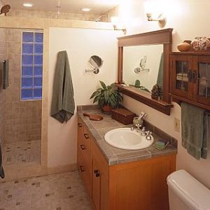

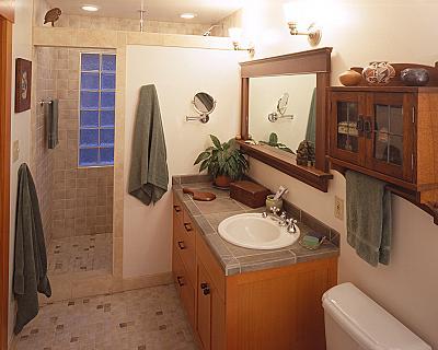

    I did mine with no door. I took the full width of the room (6 feet) and the depth is a bit less than 3 feet, probably about 33" or so. The doorway is on the left, and the shower heads on the right.
    In part it depends on shower head placement, and does it matter if the floor gets wet? You might also want to consider a rain head, as it does not spray water around as much.
    Mine seems to work fine, and I get lots of compliments on the design.
    This seems to be the only picture I have handy.
    1. Johnny1985489 | Oct 05, 2005 06:03pm | #2
      that looks really nice. How high is the step? do you get much water outside of the shower?
      1. BryanSayer | Oct 05, 2005 11:02pm | #5
        The shower floor is about 2" of mortar maybe a bit more. I think the curb is 2X6 (plus the tile) but it might be 2X8. If I remember I'll measure when I get home.There are two shower heads, one on the wall to right (fixed) and one on the wall behind the sink which is a hand held unit. There was supposed to be a third one (rain head) but I went out of town when the plumber came (grrrr.... It is on the GD plans!). But truthfully, I'm not sure that would have worked here that well. Anyway, if my wife starts swinging the handheld around, the floor gets a little water. But mostly it is from stepping out of the shower, not blow by from the heads. The fixed head is a fairly gentle spray.

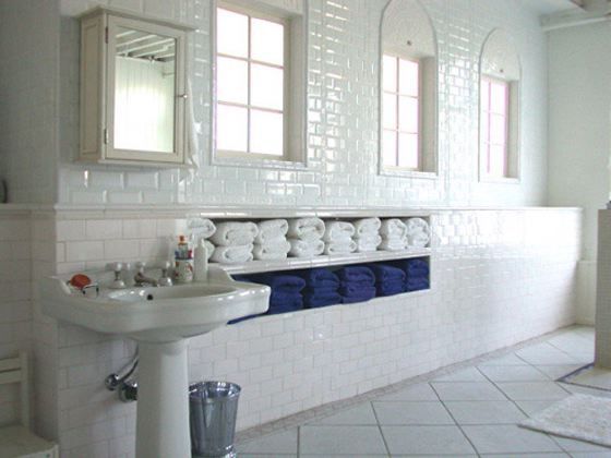

      Check out this loft in New York Cityhttp://www.garysloft.com/lofts_2/index.php?mode=view&album=2nd_Floor&pic=2nd_Floor14.JPG&dispsize=640&start=0&locscout=f124f4ad5a5d77d95bc376abd91d933ahttp://www.garysloft.com/lofts_2/index.php?mode=view&album=2nd_Floor&pic=2nd_Floor17.JPG&dispsize=640&start=0&locscout=f124f4ad5a5d77d95bc376abd91d933a

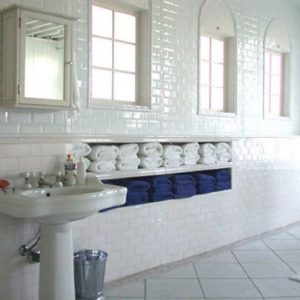

        You know these folks?
        Got to wondering what they put on the upper brick to get the gloss in this pic. An epoxy maybe?

          JeffBuck | Oct 06, 2005 06:18am | #13
          that's not brick ... (doesn't look to be, I should say)
          that's ceramic tile set in a running bond pattern.

          1. rez | Oct 06, 2005 07:00pm | #15
            Well ya, now that you mention it. No noticable imperfections or brick chips anywhere. Man, that's alot of tile tho'.
            What are those narrow verticle runs up near the sides of the windows?
            Makes me think the window top arches are covered in ceramic.

            JeffBuck | Oct 09, 2005 06:16am | #19
            "What are those narrow verticle runs up near the sides of the windows?"
            looks to be just a nice trim tile ... aka ... profile tile.
            went back and took a close look at both pics ...
            that is one fantastic looking job ....
            I still think is it all tile. Might be some sorta paint or sprayed glazing over brick ... but I'm thinking it's just a really nice tile job.
            I didn't open both links till now ... just saw the pic U opened and pasted.
            saved them both for "customer ideas" ... I'd love to sell something similar!

          3. piko | Oct 09, 2005 07:27am | #20
            Pilasters.All the best...
          4. piko | Oct 09, 2005 07:36am | #21
            What are those narrow verticle runs up near the sides of the windows?pilastersAll the best...
        3. Sbds | Oct 06, 2005 09:00pm | #16
          No one lives there. The loft was built for photo shoots.Go to there web site and you can e-mail him.http://www.garysloft.com/
