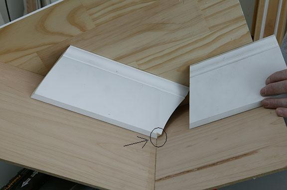

In a previous post, someone referenced Gary Katz’s website where he discussed the 135 degree cope. In his photos, IMHO, the crown looks upside down. (see attached photo)
Maybe it’s different with the crown he’s using, but compared to the standard crown you can pick up at the big box, it doesn’t look right to me. Of course the crown can go either way based on the customer’s preference, but what is the standard way to hang it?
In the crown I've installed, I've placed the extra detailed edge
down. Your picture is upside down from the way I would have installed
it.
This doesn't mean I'm right!
I agree with brooks; that crown seems upside down to me, too.
Maybe it was just for demonstration purposes?
The crown in that photo is upside down.
As to why?......I've no idea.

I'm wondering if he installed it that way just for demonstration purposes. Check out the photo I've attached. With it upside down, this little wedge cut would have been easier to cut (and easier to see in a photo)
