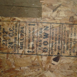

            Here is the pic, I'm not sure if you will be able to read it or not.  I measured the piece it was 47 1/2" wide from where the groove started(the edge of the piece), to where the tongue started.  It was 47 7/8" from where the groove started to where the tongue ended.  The piece was cut in half, so I couldn't measure the length.

            I was working in a house today and my son pointed down to the floor we were standing on, it said "This Side Down", ha.About 20 years ago I saw my first osb. It was sheathing for the roof we were framing. I figured the slick side had to be for waterproofing, better put that up. Ran the first row from inside, got out on it to run the second, talk about a slippery richard.And, add me to the gappers, even with Advantec...I hate grinding Don't worry, we can fix that later!

            I noticed on the Advantech it says sized for spacing, and it still measures a full eight feet. The sizing is in the T&G side. The edge gold measures shorter too. I've heard before that the stamp says this side down so the inspector can see the stamp from the underside of the roof, and joist system. Whether this has any credence I don't know but . But I remeber someone telling me this since this discussion has brought different recollections to the surface.
