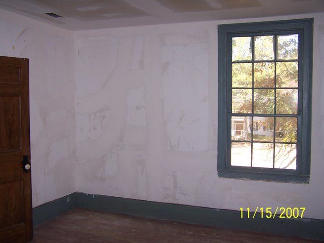

Here’s the final result of that plaster repair last week. Since the walls haven’t been completely skim-coated, a lot of the old texture shows through.

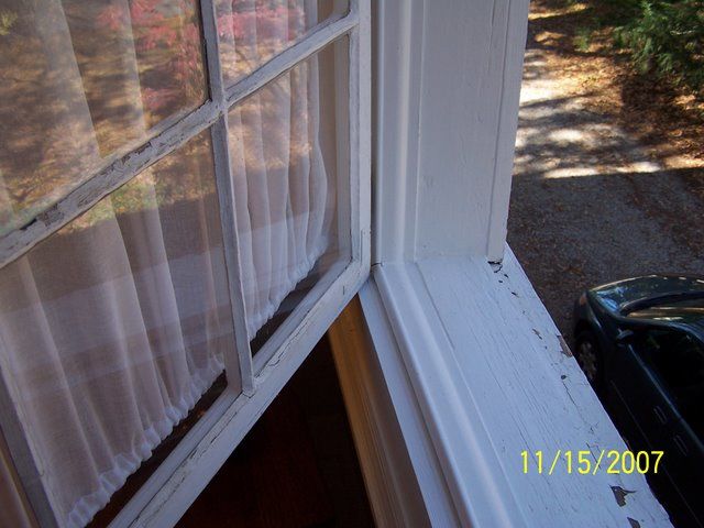

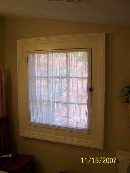

This was a hinged old bathroom window that you could literally stick a pencil through the gaps; frame was racked 1″ down to the right. Client asked me to replace it with a DH, but you can imagine how a short fat DH would look on an 1837 house! I removed and enlarged the frame, adding spacers to move it into the room, added new interior jambs, trimmed a bit off the old sash to square it, and used the compression-type door weatherstrip from Depot on the new jambs. Seals tightly now –
Here at the bottom you can see the transition between my new level jamb and the old crooked jamb.

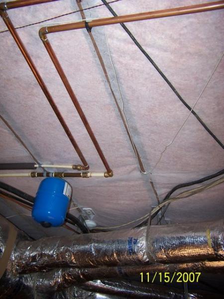

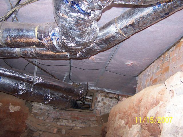

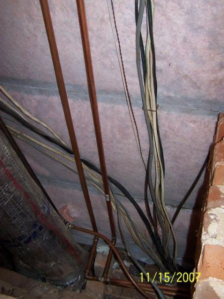

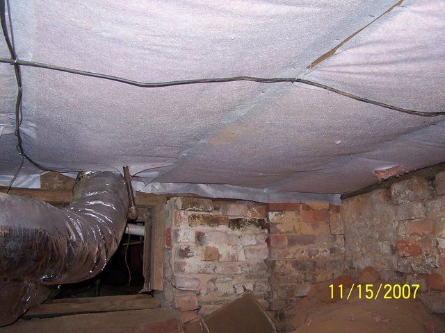

Here’s an example of netting and insulating under an old house (just one room done here) Old joists are ~2-1/2 x 9; 22-29″ OC. Cut Insulweb into 26″ wide strips; worked one bay at a time. dropped all the wires down; worked around the HVAC and plumbing; had to keep two elec boxes exposed. Densely blown in pink glass. had to net under some of the floorboards, too – big gaps in winter. I had about three hours in it; insulators took just moments.

Forrest, great photos, thanks for posting. I love the trim color in the first photo, and that 9-over-6 window. It's really quite a large window, what are the dimensions of the panes?
Is the baseboard flat stock, or is it beaded along the top edge?
Allen
Not sure about the window size - it is pretty big. Base does have a bead, but it and the casings were all installed on top of the lath; plaster finished to them. Over the years of repairs, those beads are getting buried!

After skim coating do you do any texture? You're matching old plaster? I learned how to do a sand finish that looks just like old plaster by blowing three double handfulls of #20 or #30 silica sand in 5 gallons of thinned out joint compound thru the hopper gun at about 60 psi thru the biggest orifice.
Comes out really flat, and sandy like plaster. I mesh tape cracks, then skim rooms and blast 'em with this and it looks great. A few dollops of bonding agent helps it stick to old painty surfaces. Rough up first with sanding.
This technique might be old hat to a wall-pro but I just learned of it and it works great.

Curious about your insulation choice. Why not the rolled insulation, one full width and one cut to fit with some good tape holding them and than the Simpson wires to hold in place. Seems like it would have been less work.
Kevin
Edited 11/16/2007 11:02 pm ET by dockelly
Batts just won't stop air movement in those wide random chases with 1x8 non-T&G floor on top. Plus, would have been lots of cutting an stuffing and tape and mess!
