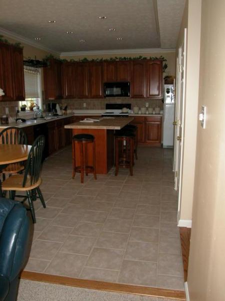

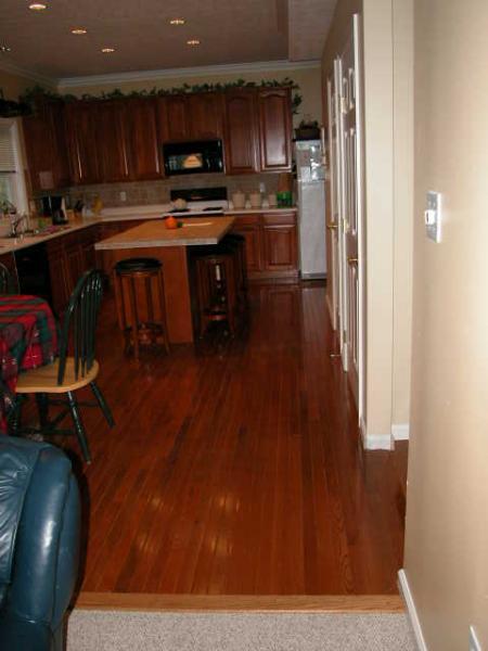

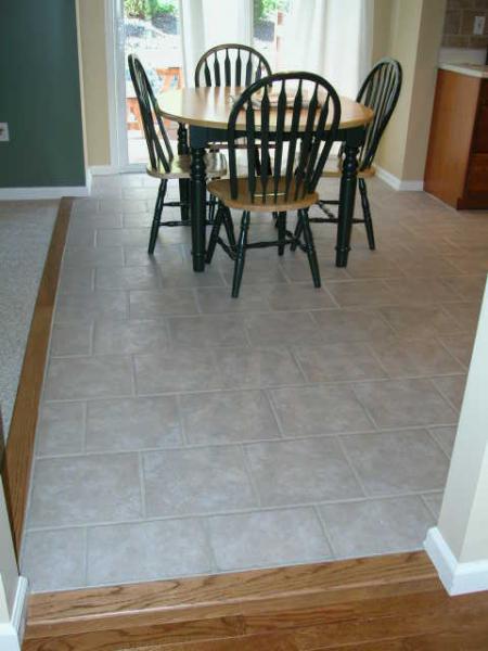

pics ...
old and new

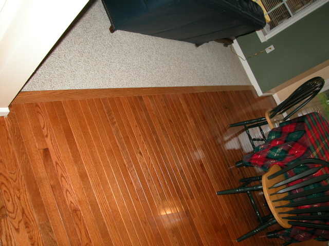

this part should probably be in const tech or the pics section ...
but notice the clever "re-use" of the custom carpet to tile/wood threshold!
That's one fancy carpenter guy doing that kinda stuff, ya know!
It's finish screwed and rabbited over the gold metal carpet strip ... removable ... in case they ever have to pull the carpet ... now that one side is "grooved" ... more of a tilt operation as opposed to remove ....
