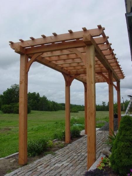

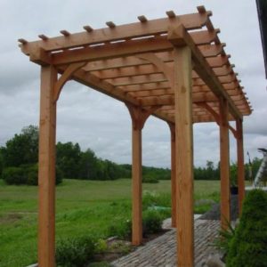

          3. theslateman | Aug 23, 2008 02:11pm | #19
            Heres a similar one my friend did for me several years ago.
            I want to build the next one myself.
          4. andybuildz | Aug 23, 2008 02:39pm | #20
            PERFECT starter project. Has the corner braces and the typical elements you'd need in any big project. I'm psyched for you Walter!! You cutting your own timbers from logs by chance? You could always get an inexpensive chainsaw mill/guide to start out with from Bailey's. http://www.baileysonline.com/search.asp?SKW=alaskan&catID=198http://www.baileysonline.com/search.asp?
            PS...one thing I do know is green wood is far easier to work with then seasoned timbers.
            RD : )  http://www.ramdass.org/
            Blog     http://cliffordrenovations.com/WP/
            oh yeh!! -->  http://www.youtube.com/watch?v=muhvpNuVN4Y
          5. theslateman | Aug 23, 2008 03:07pm | #22
            Andy,
            We have a local yard near the Coast that gets lots of DF in on rail cars -- then resaws to what you need.
            I'll go that route for this project.
            Thanks once more.
            Walter
