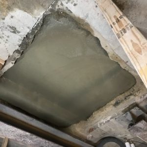

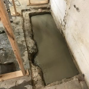

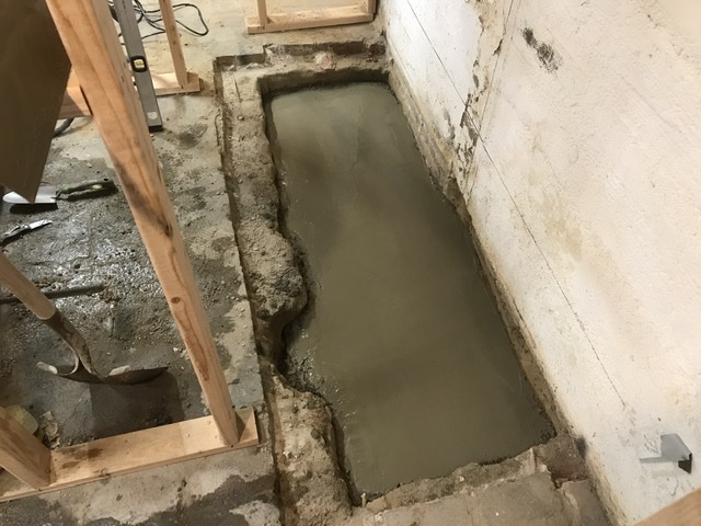

First pit filled tonight! I have to say...all the advice here was so helpful! Took me 2 hours start to finish...but I was happy with that.
And the concrete vibrator made all the difference! That thing was worth every penny!
Nice work.
Thank you for your advice

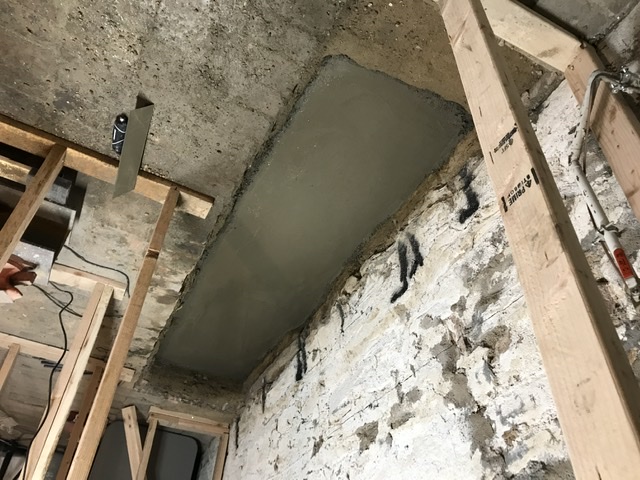

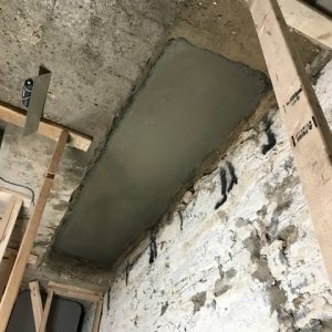

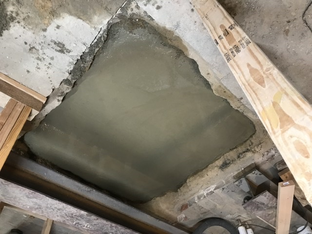

All 3 pads are complete! Thanks again for all the help and tips! Definitely made a difference.
